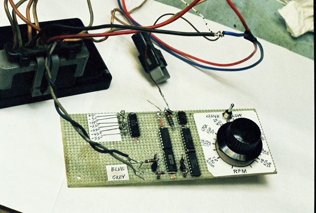

BRUCEROE
Posts: 96
EDIS CURRENT
Post by BRUCEROE »
Guess I should have said, this was run on the bench using my trigger wheel emulator circuit. And up to 4 coils/8 spark plugs. That makes it easy to get any coil config desired, no hot screaming engine. Bruce Roe
