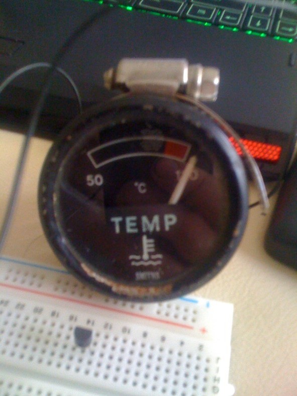

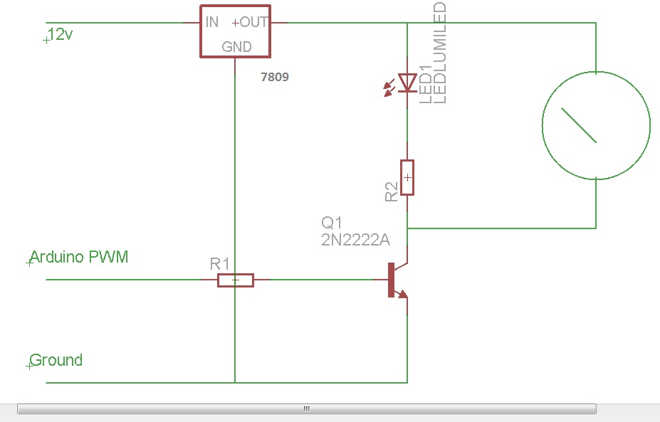

Right done my first real test on a Smiths temperature gauge using PWM from the arduino and so far the results are promising. I used a very basic circuit for the test which could be improved up on (see circuit diagram). I monitered the voltage regualator temperature by touching it with my fingers to make sure it wasn't over heating.
I have included phots for every step
The Smiths gauge has an internal resistance of 60 Ohms (just measured across it with a Ohm meter. I tried just putting a 5v power supply across the terminals of the gauge and it wouldn't even reach maximum, "she just canna do it captain"!!!
So out with a 9v 1A voltage regulator on a 12v source and the max is easily reached.
- Circuit diagram
- Gauge 9v.jpg (105.07 KiB) Viewed 20585 times
- With 5v supply
- Gauge 5v.jpg (81.58 KiB) Viewed 20585 times
- With 9v supply
- Circuit.jpg (50.9 KiB) Viewed 20585 times
