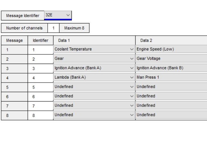

MBE Canbus Gains and Offsets
After a bit of searching through the Microsoft Access based database for AIM Mxl software I believe I've managed to isolate the gains and offsets required to convert the Canbus stream into something useable
- MBE Gains.JPG (51.85 KiB) Viewed 8311 times
Is the raw stream on Canbus from MBE different?
The address ID does not increment but the first bit becomes the offset.
How can I script to ensure Racecapture can read this properly
Address ID is in RED
Offset is in Blue

1) Setup the MBE 992 Output for data collections with Easimap 6, using the documentation from AIM sports
2) Use the RCP Mk2 as a CAN Sniffer to see any CAN messages
3) With my setup, the 995 mini-dash uses the CAN BUS to cycle through 7 different screens: Gear, Oil Temp, Oil Press, Fuel Press, RPM, Water Temp, and Battery Voltage. When I run the CAN sniffer, I happen to also get 7 different CAN ID's. The values run from 0 to 66,600. At this point, I can't figure out which is which.
4) Tonight, I'll run my engine a while and go through a cycle while logging the data. Hopefully the data will make sense on which CAN ID equals which parameter I see on the dash. Then it's a matter of using the gain and offset to get something that makes sense.
