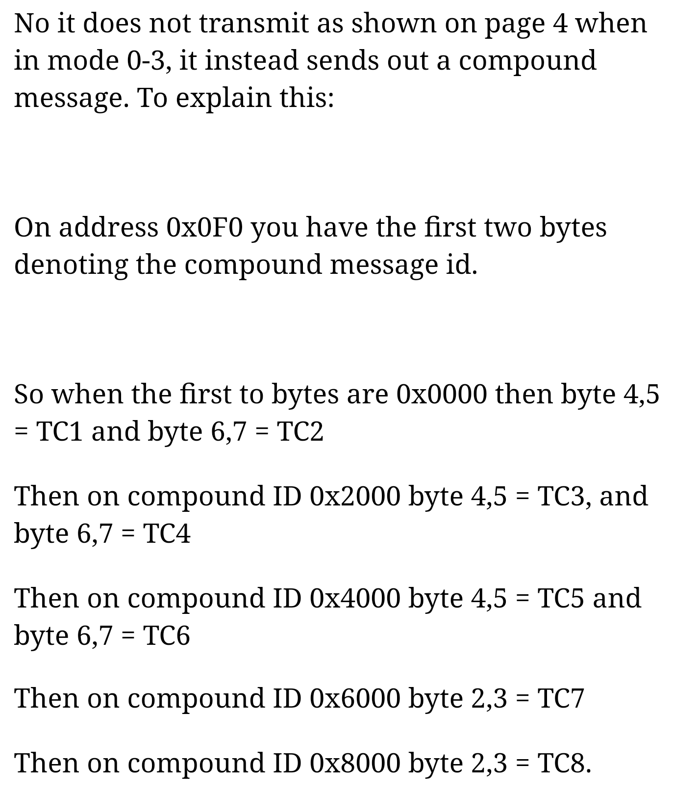

Hi all,
Goimg to be implementing a Racegrade TC8 on CAN bus 1 with my RCP mk2.
Due to a current issue with Racegrade's firmware, I have to use the default MoTec E888 mode, which uses compound messaging to distribute each of the 8 TC channels.
How do I extract this in Lua? Help!

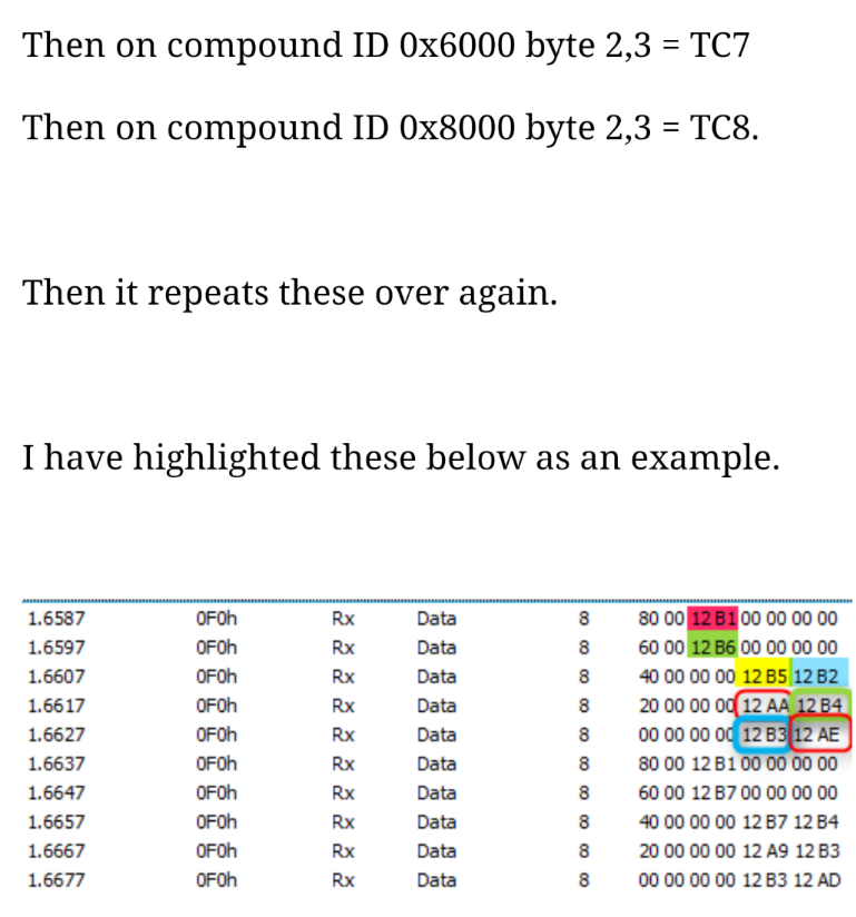

Ok, so as I do not have the actual Racegrade TC8 module yet, I created the following script:
datacanEGT1 and 2 are some dummy values I created in the same format I'd expect to receive over CAN bus from the RG TC8, idcan is also a dummy variable to simulate CAN address of the RG TC8.
Bassically, if this were a real CAN stream, datacanEGT1 and 2 would be one variable only, of which the while / if loop would extract data from the correct bytes depending on the TC channel required.
With this dummy script, I have managed to get decimal values of EGT1 = 20 and EGT2 = 21, which is what i've put in bytes 4 and 5 for the dummy values.
Comments? Criticisms?

Hi Adam,
we've been in contact already via FB pm...
Your script above is not that bad, anyway from a quick look at least you have the byte numbering wrong when you want to receive data from the TC8:
Generally speaking about CAN the bytes are numbered from 0-7... i.e. the first byte is called byte 0, the second byte is called byte 1 and so on...
However sadly within the RaceCapture script the bytes are named 1-8.
With this in mind when you watch out for byte 4+5 to get TC1 as an example within your script it will be bytes 5+6 that you want specify.
