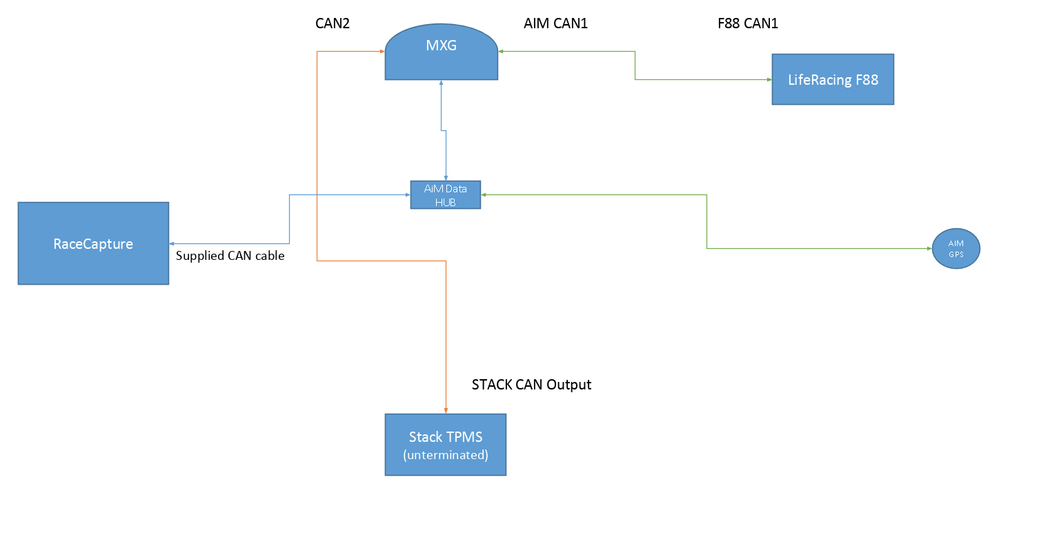

Hi guys,
I have the STACK TPMS connected to the CAN2 network on the AIM MXG (CAN1 for the ECU) and it is woriking good. Both channels from ECU and TPMS are beign readed and recorded by the MXG.
My RCP is connected to a Data Hub (using AIM dashboard telemetry cable) which is connected to the CAN EXP port of the MXG.

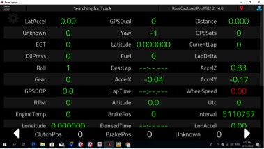

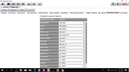

I'm running the AIM SmartyCam preset but nothing is transmitted / received by RCP (except from the internal channels like yaw, pitch, roll, etc). I'm lost after two days trying everything.
Could be different the CAN mapping from the oldest AIM (Like MXL pista) products from the new ones (MXL2, MXG) ?
Someone running RCP with MXG, MXS, MXL2 could provide some advice?
How could I verify if RCP is receiving something from the MXG?
