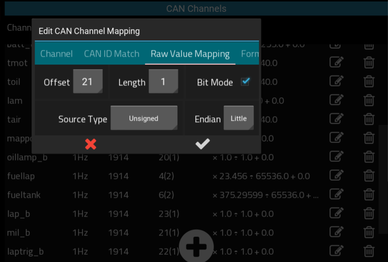

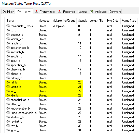

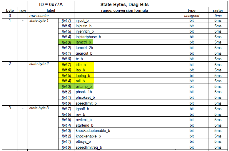

Seems like there could be a bug in the Bit Mode Channel Mapping. Bits with offset >20 don't seem to work. The green highlighted bits work. I have toggled the ECU internal variables for lamctrl_b and oillamp_b and see the corresponding signals toggle in the RC Dashboard. The yellow highlighted ones don't seem to work. RC Track configuration file attached.
Yes, the raw values of 0x77A Byte 2 all work. With a simple 1:1 conversion I can toggle bits 4, 5, 6, 7 and see the physical value for that Byte change accordingly in the Dashboard.
And no, I didn't try Byte 3 yet, so I can't say if this is only limited to bit offset 21 to 24, or if also higher is affected.

I'm trying to use the "Bit Mode" to map individual signal to a 0/1 bit flag. It's much more convenient than bitmasking the byte via Lua script. :)
It works up to 20. So oillamp_b work just fine. But mil_b, laptrig_b and lap_b don't work. It's like Offset >20 just doesn't work. I've tried both Little and Big Endian. And yes, I see the values change when I map the entire Byte 2. No signals mapped with Offset >20 work.

@brentp I figured it out. It's not that they don't work above 20, it's that the bit numbering is backwards.
viewtopic.php?f=38&t=6314
I'm hoping this is an easy fix, and you can get this updated right away since all you have to do is start counting from the other end ;)
P.S. so I think it was kind of dumb luck that I got some bits to work correctly by adding 1 to the offset.
