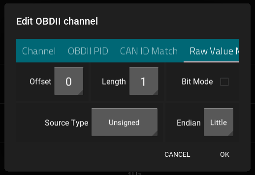

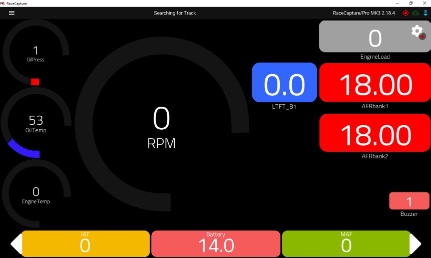

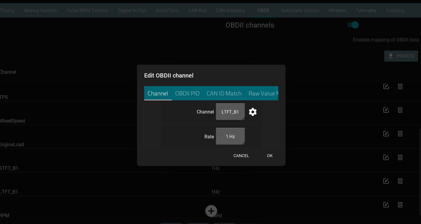

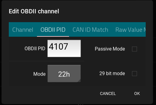

I've reviewed this thread, as well as the OBD2 wiki (https://wiki.autosportlabs.com/RC_OBDII), and I still can't get the OBD2 PIDs I need to read correctly on my racecapture.
I need to log short term and long term fuel trims for my tuner (for each bank), and it looks like those are standard OBD2 PIDs. I've tried on both 01H and 22h modes, following the wiki as best I can, still no dice.

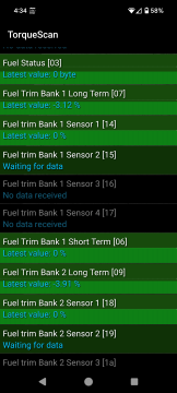

I know its not working because my LTFT_B1 in torque is -3.8% and I show 0.0 on my racecapture dashboard after querying the channel.
The formula is simple ((A/128)-100), so I imagine my problem is simply in the querying the correct address.
Looks like it should be 4107 in hex per torque, which converts to 16647 or something like that in decimal. I've tried both in the channel setup.
I imagine this has been figured out since Brent has an E36 M3, can anyone steer me in the right direction.
Thanks!!
-Tyler

Posting the remaining screenshots

Just wanted to close the loop here and say I got it figured out. You have to have 2420 in the canbus tab, big endian selected, and whatever offset and bit length works.
If anyone has any questions, message me and I might be able to help.
