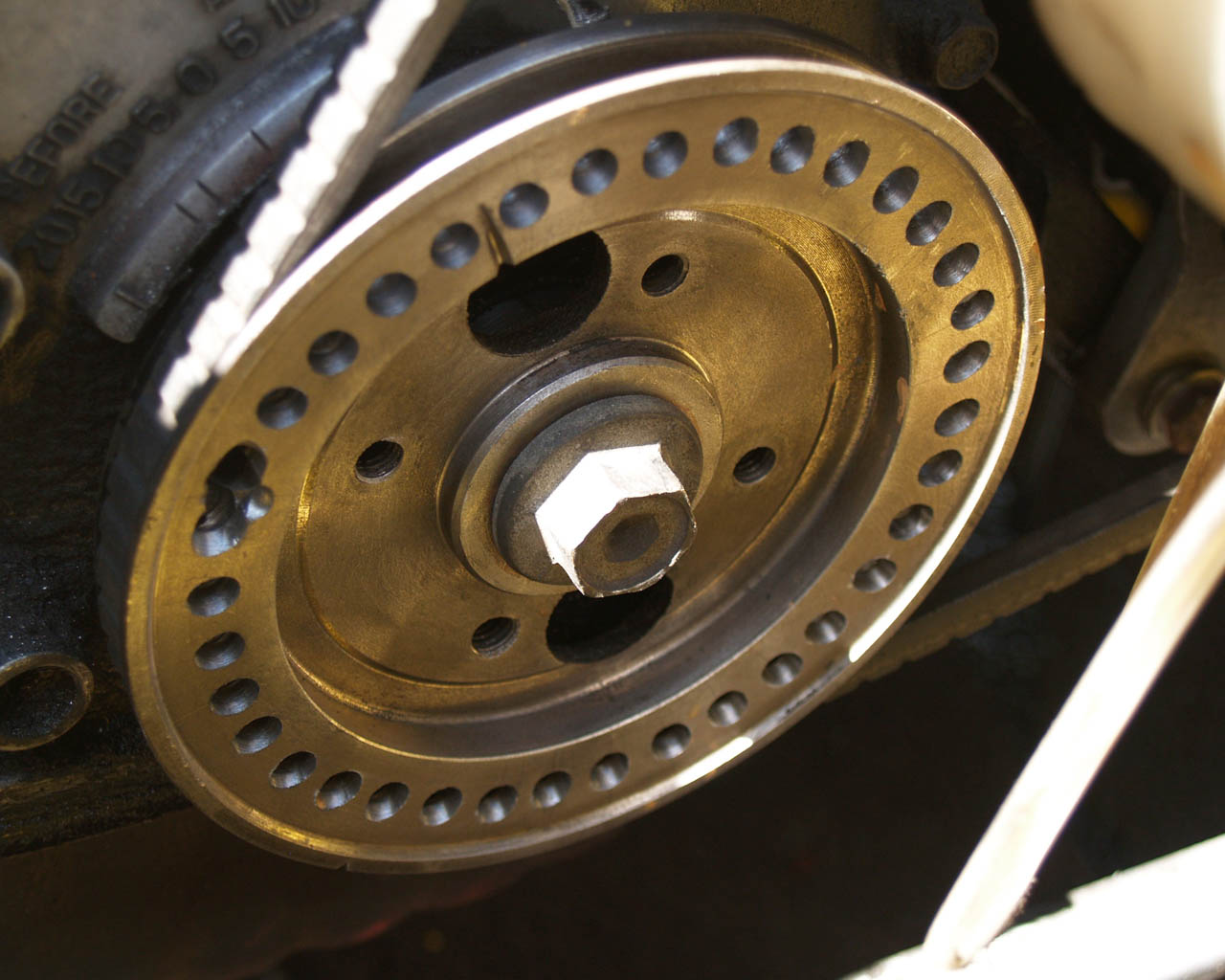

Trigger wheel could be out as much as 3 degrees but average would be 1 degree. Just scrapped it up this arvo to test it.
Will take a photo of the wheel maybe tomorrow if i get time. If you have ever seen a 3tc just imagine the crank pulley with holes drilled in the front of it.

firstly, the trigger wheel. looks like it should work. another person on the forum recently posted a picture of similarly drilled crank pulley (holes drilled in from the periphery), with a perfect waveform on a 'scope. so your wheel certainly should work.
as opined earlier, i reckon, applying all the expertise which can be applied by an amateur know-all looking a photo on a discussion forum, that there would likely be <1deg variation between any of the holes. so it cant make any bucket on your map out by more than 1deg. given that timing can vary from, say, something up towards 40deg btdc, to tdc, i dont think that is ever going to make any discernible difference to performance. if you were trying to maximise power in an envelope-pushing race engine, well, maybe. but for thou and i, that's good enough. as ever, IMHO.

Thanks Alexander, it's good to get a second opinion on the trigger wheel. I've got a spare pulley that i will take and get machined properly just in case but this one will do for now.
Halfway making a bracket so I will get back to it and let you know how I go.
