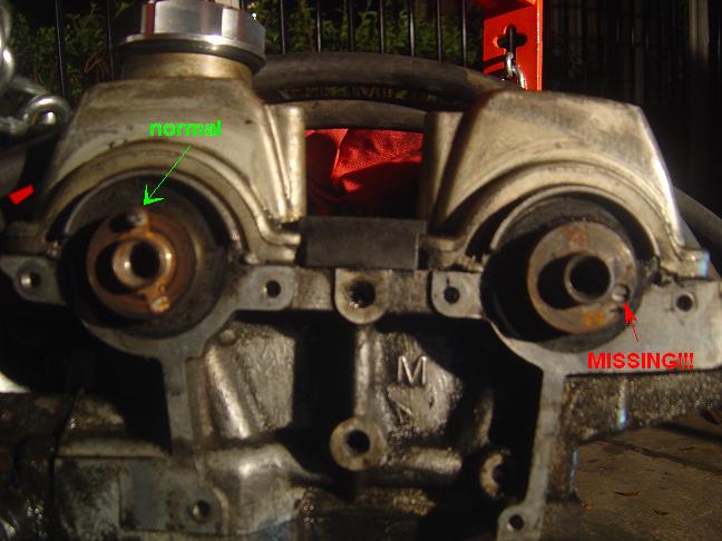

ok, pulled the engine today and as i was swapping parts over to the "new" engine, low and behold the cause of all the heartache. (see attached image)
kicked my self several times and my friend was saying he knew we should've just put the perf. cams in to begin with. then we would've discovered the problem sooner than MUCH later. before pulling the engine!!! :oops:
thanks everyone for chipping in with their know-how! i guess you can say we were all right in believing the timing was off somewhere.
anyway, now onto mjlj living. it's going to be a long weekend... :roll:
Wow- It's amazing your engine even ran with random cam timing like that. Incredible.
Hope things are smooth sailing after this! Keep in touch.
