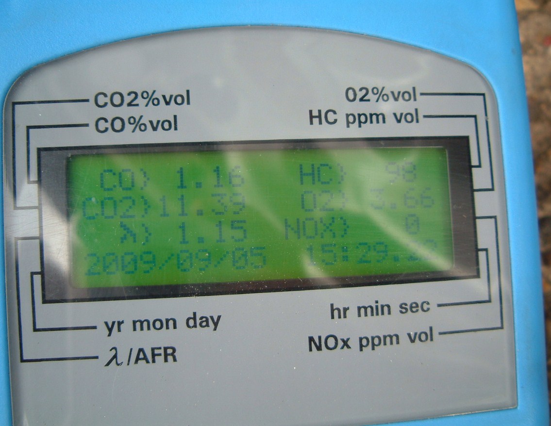

I just use my portable 5 gas analyser which has a lambda reading & run her up the road,as long as you can get it near to 1.0 its running spot on,it also gives you the HC measurements.
alfawiz emissions on megajolt.JPG (176.03 KiB) Viewed 40116 times

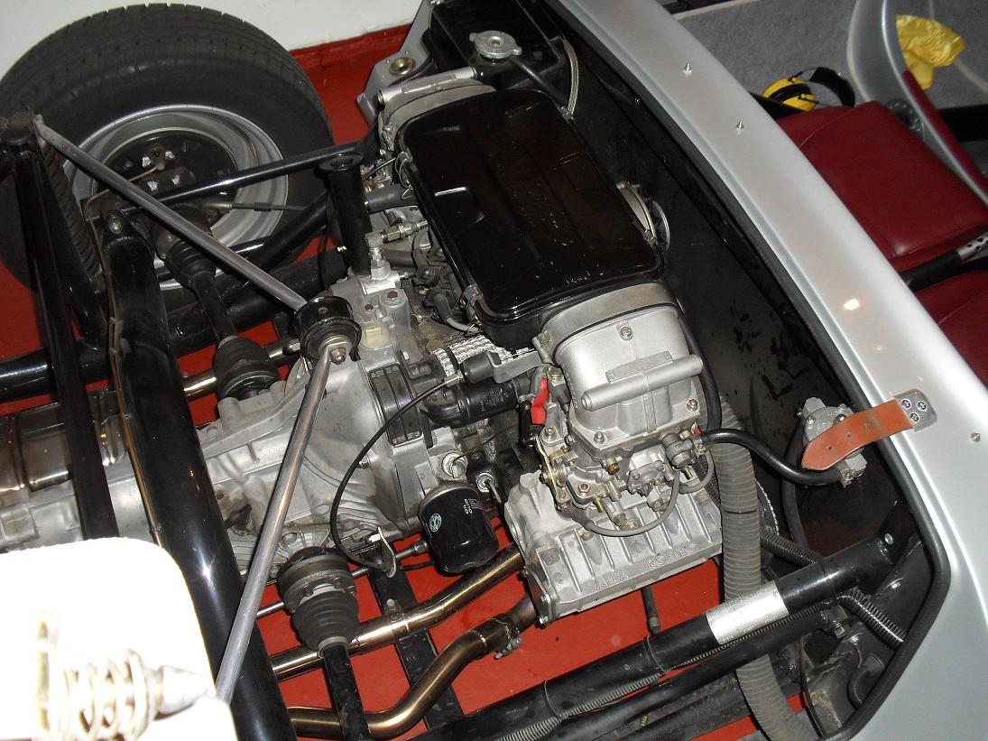

I fitted Megajolt earlier in the year and spent a couple of hours on the rolling road at Northampton Motorsport to get it tuned correctly. Since then I've done about 2K miles.
Alfa Romeo flat four, 1700, 8 valve.
TPS
megajolt engine bay.JPG (172.34 KiB) Viewed 39447 times

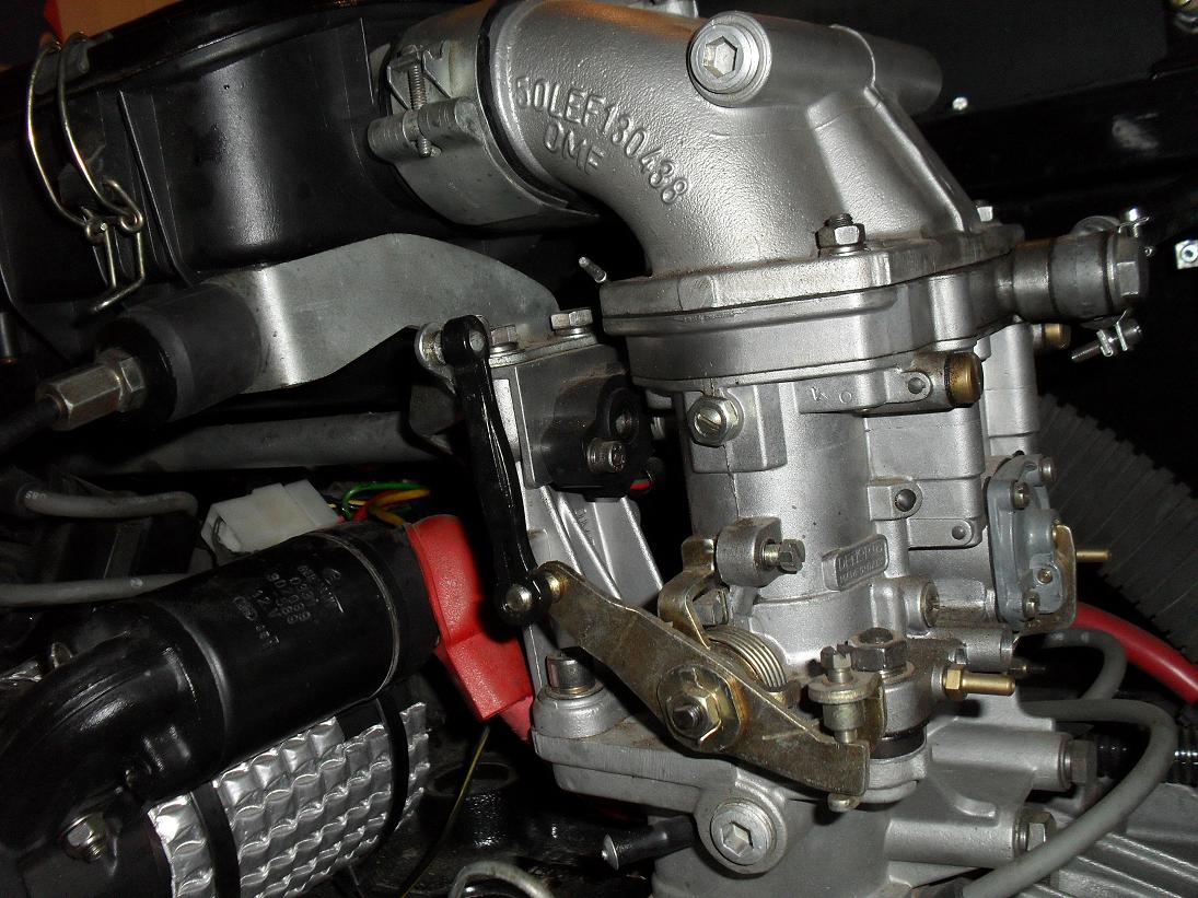

TPS mounted to end of throttle linkage.
megajolt TPS.JPG (168.8 KiB) Viewed 39447 times

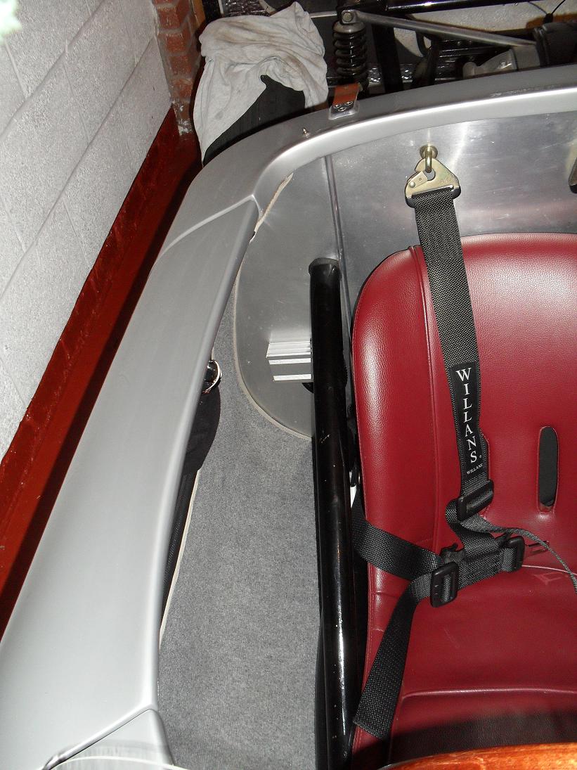

megajolt cockpit.JPG (166.14 KiB) Viewed 39447 times

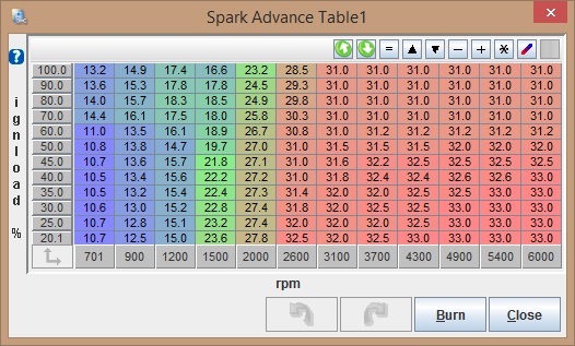

Hello,
I have tried this ignition map for my MegaSquirtII running my Alfasud 1.7 8v Boxer engine, but there was something wrong, the engine wasn't running fine at all. I'm not sure where is the problem to be honest.
I have a basic ignition configured in my MS2, just a single input from the hall sensor & that outputs to the ignition coil.
Here's my current ignition advance table that I've been running for a while, it's still not good in higher RPM & with higher load, it injects so many fuel which causes black smoke =\
Hope someone could help :)
Ignition advance for Alfa 33 1.7 8v boxer engine (NOT PERFECT)
