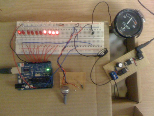

- Posts: 704
- Location: Fareham, GB
A second try and aren't Arduino's, well programming, fun. I'm still only very basic but have learnt alot more recently getting hands on. I have mainly been teaching myself programming by trial and error, changing the code slightly on working examples and seeing what happens and learning from mistakes, always the best way to learn as long as it isn't too expensive
This time i have managed to use the PWM output, now i understand the how to impliment it in the code it really is quite easy, get me!
This time it looks a bit more professional and there aren't any phots of me lurking in the back ground, lol. I have used a 9 LED bargraph to compare against. The last LED (on the left) is PWM so gets brighter with increased duty cycle. The little circuit bottom right is something i got one of my lads to make in the office. It's basically 2 voltage regulators (9v & 5v), which can supply about 1amp current so plenty of juice here and this connects to a 12v mains supply from a spare adaptor i had lying around, always handy to supply larger circuits or gauges.
The input is just a potentiometer supplied with 5v at the moment, so i will have to fettle the code a bit to get it to work with a voltage divider and thermistor values but now i have the basics it shouldn't be too difficult.
So here's the pics
So here's the pics
- IMG_0470.jpg (57.96 KiB) Viewed 17163 times
- IMG_0469.jpg (61 KiB) Viewed 17163 times
- IMG_0468.jpg (59.48 KiB) Viewed 17163 times

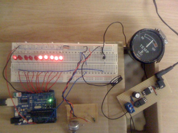

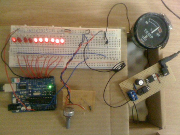

- Posts: 704
some more
- IMG_0473.jpg (58.67 KiB) Viewed 17162 times
- IMG_0472.jpg (60.72 KiB) Viewed 17162 times
- IMG_0471.jpg (56.33 KiB) Viewed 17162 times

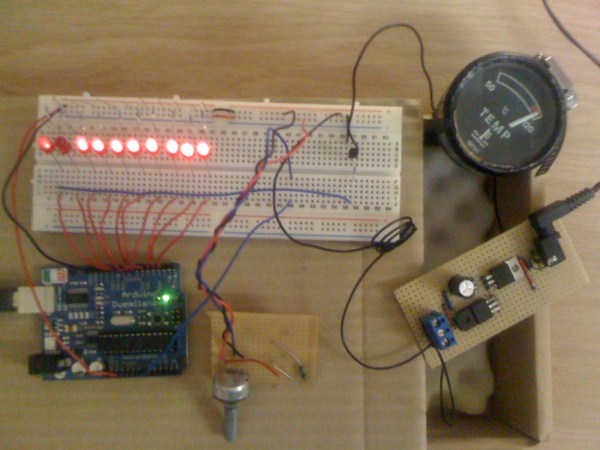

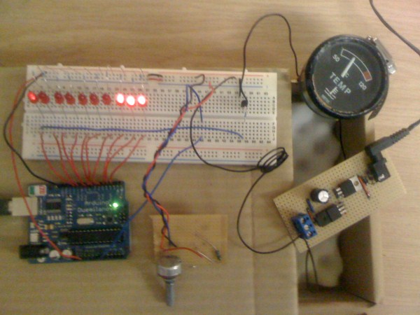

- Posts: 704
Finally
- IMG_0476.jpg (58.47 KiB) Viewed 17161 times
- IMG_0475.jpg (58.22 KiB) Viewed 17161 times
- IMG_0474.jpg (59.05 KiB) Viewed 17161 times
