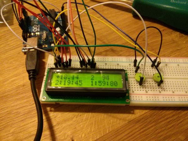

It was a rainy weekend, here in SF. So, I got some hacking done. I decided to tackle the communication side of things, setting aside design work. I have some bits and pieces lying around, like a 16x2 character display, and an arduino uno. So the first thing I did was get those hooked up to each other. I decided to implement a working prototype of a display with a series of "pages". So the first "page" displays lap times, the next displays engine stuff, with a final page for debugging.
- Arduino with display
- IMG_20140208_114620.jpg (89.06 KiB) Viewed 17820 times

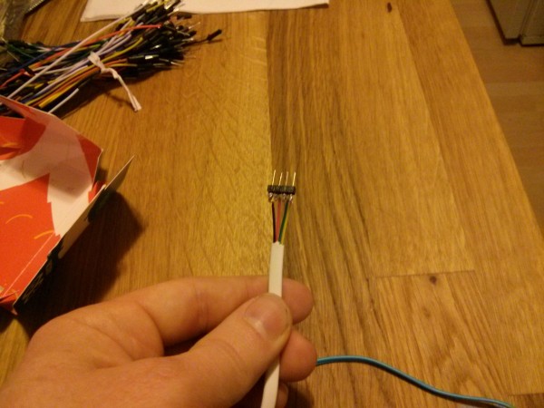

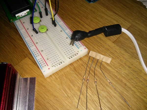

So, with that out of the way, I wanted to tackle the electrical interface between the arduino and the RCP. Digging through the documentation, I determined that the telemetry port is basically a 2-wire RS232 serial port (no flow control). I hacked up a phone cable, and then soldered wires to 4 pins from a break-away header. Then I sealed the whole thing up with some sugru so it wouldn't be flake city.
I tried to build an RS232 level shifter based on schematics I found on-line, but something isn't working right. At the very least, I'm not getting data out of it. More progress will have to wait until tomorrow, when I can take the whole mess down to techshop and use their oscilloscopes to debug it. Once I get that going, I can move onto the next phase, which is reprogramming the RCP firmware to speak my binary protocol.

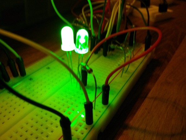

Also, for shits and giggles, I experimented with "converting" water-clear LEDs into diffused leds with a little sandpaper. The attached photo is a pretty dramatic illustration at how this improves angular brightness.
- IMG_20140209_115925.jpg (64.06 KiB) Viewed 17816 times
- IMG_20140210_205713.jpg (92.78 KiB) Viewed 17816 times
- "diffused" and clear side-by-side comparison.
- IMG_20140127_010753.jpg (57.19 KiB) Viewed 17816 times
