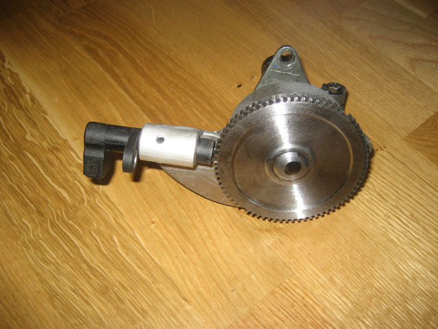

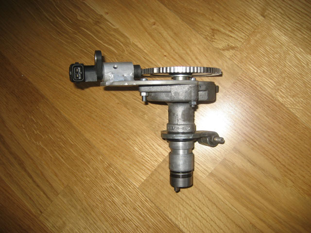

Just to follow up on the thread. Here are some images of the converted dizzy.

nice work, patriq!,
just watch your fingers when you hand is in the engine bay - it might be a good safety precaution to add a cover over the wheel (realising of course that you may have already done so...)
it is a neat solution, particularly, in that it uses the stock vr sensor, which comes almost for free with the used EDIS units. i note that www.trigger-wheels.com sell wheels down to 2.5" diameter. for the benefit of those reading this thread regarding their future project, i suspect you can go even smaller than 2.5" and still use the ford vr sensor. that would usually allow a distributor to be converted and still have the moving parts hidden under the cap. you can then cut the top off the cap, and glue in a flat piece of acrylic sheet so you can see in, and amaze your friends :).
anyhow, those are all just some additional thoughts, and not to take away from your very neat work, patriq. well done, and great to see people being inventive when the need presents itself.
regards
alexander.

Thanks !
Yes, the thought has crossed my mind about a cover. Haven't really done anything about it yet. (Haven't had spark yet either....)
I was in contact with trigger-wheels.com, to see if they would manufacture a 72-2 wheel. But it was to expensive for them to do.
This wheel was done by an enginer who manufactures parts for helicopters. So you could say he had the tools for the job !
Your solution with the smaller wheel - I would rather have done that. But when I had mine done, I wasn't sure that the size of such a small wheel and small teeth would work with the sensor. But were I to do it again - I think I'd gone your route.
(or maybe an upgrade of this dizzy later.....)
