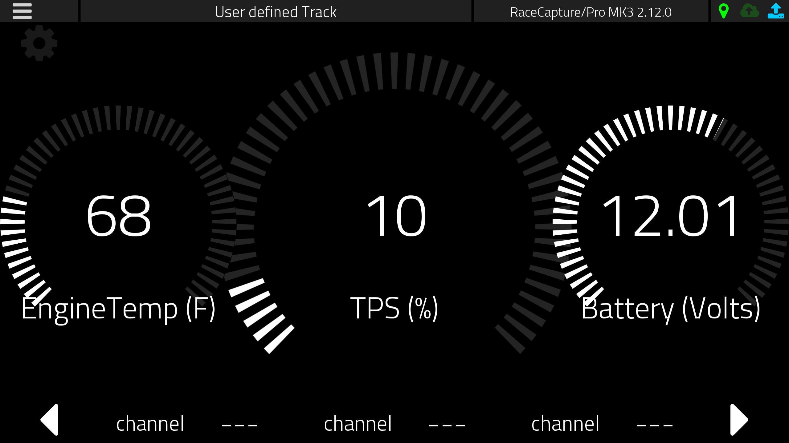

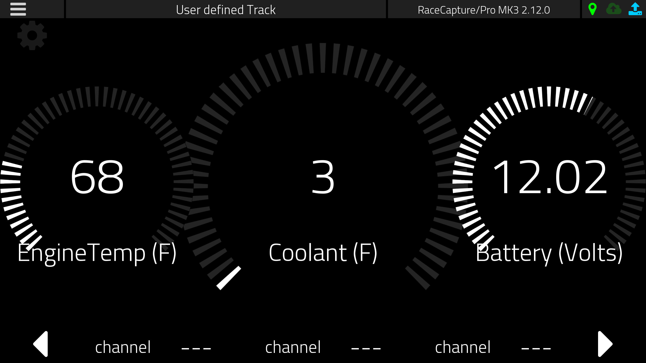

A couple of interesting things I was hoping you could point in the right direction of clearing up. Attached is a screen shot of OBD engine temp on the right and Canbus Coolant temp in the center. Any idea why they are different?

The other thing is the OBD tps shows up starting at 10% and the CanBus TPS doesnt even register. What is the preferred process for trouble shooting/editing? Also I will continue to post here what I learn, hopefully others with hydras will find it helpful.

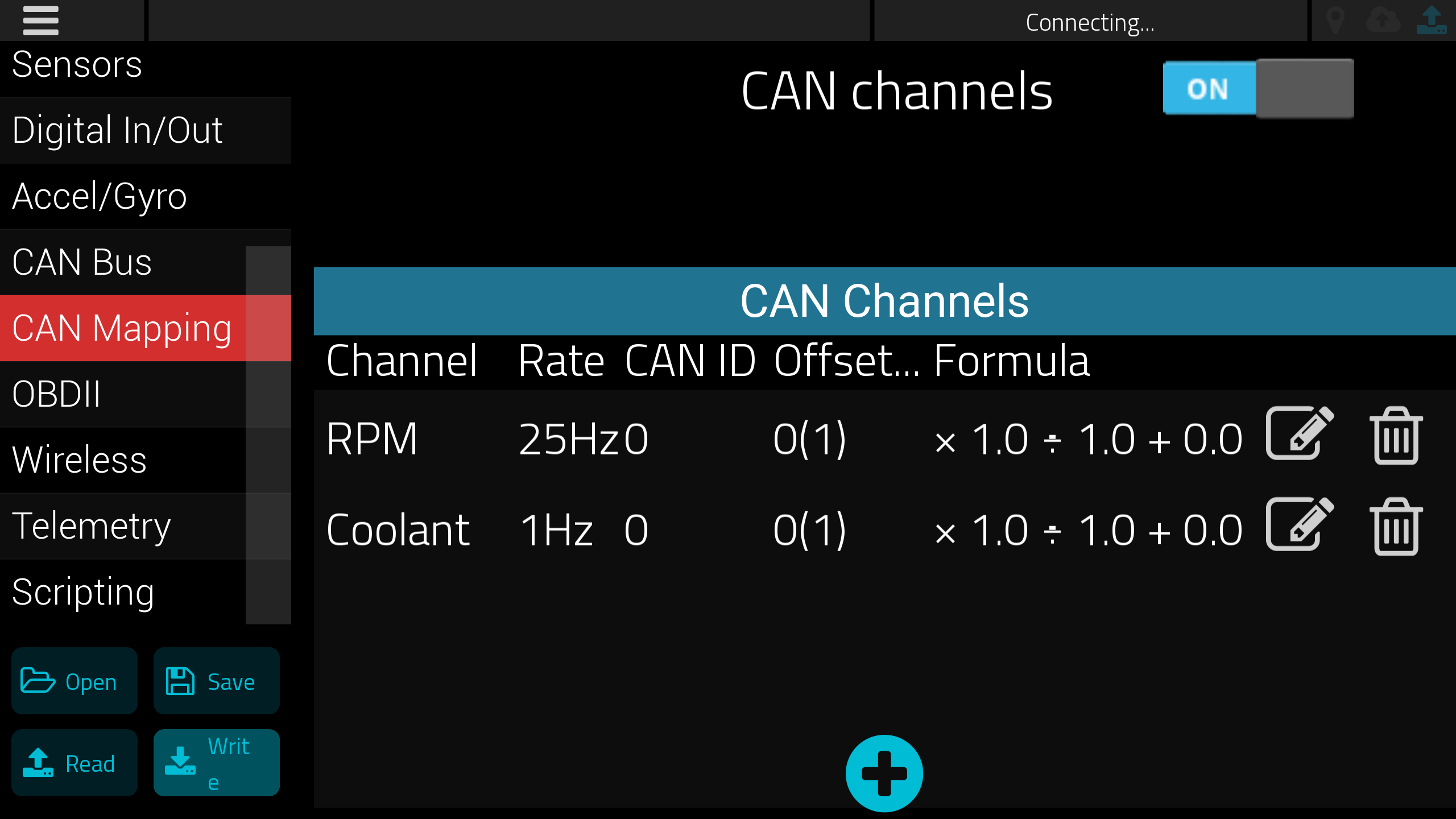

Can mappings for the CANBUS side.

I messed around the TPS formula to get it right. For the OBD II TPS youll want RAW X 1.0 / 1.58 + -16.0
OBDII EngineTemp works well, I just switched it to F
RPM also works well as standard OBDII
