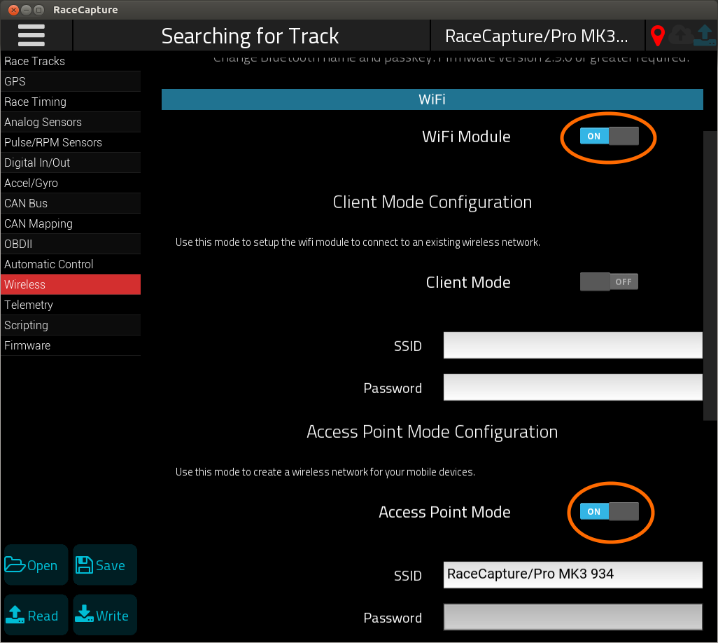

Thanks, that is helpful.
Can you:
* Power cycle RCP
* Connect to USB again
* Read the configuration by pressing the "Read" button under Setup
* Go back to Setup / WiFi
* Does the WiFi setup look like the attached image?
