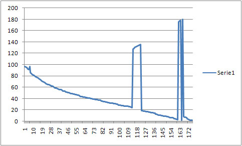

Here is a graph that shows temperature reading at each bin from 99 down to 2 degrees Celsius. I miss some values - therefor the spikes.
Somehow it seems that it's not linear, is it ?
- ADC at the x-axis, temperature in degrees Celsius at the y-axis, from reading the temperature sensor at the AUX-input.

Regarding your sensor curve: yes, it seems somewhat non-linear. Was this a plot you made from your volt meter?

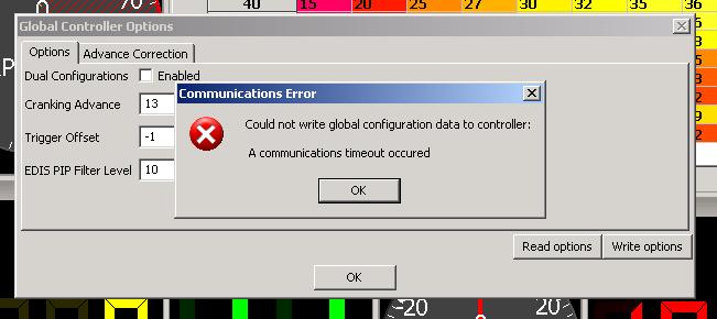

I've flashed the new firmware and installed the new software today and all looks OK on my limited setup (rpm advance only and no aux input)
When I tried writing the global configuration I did get a coms time out error but it looks to have written the data and it can be read back. I don't know if it's anything to do with the advance correction because I'm not using that at the moment.
I set my advance bins to 10 and applied a -1 trigger offset and my timing mark is now spot on.
Next thing to do (excluding the vacuum requirement) is build the aux input circuit and test that, I'm sure it'll be a few months until I get round to it though.
Cheers
Dave
- error.JPG (30.5 KiB) Viewed 46627 times
