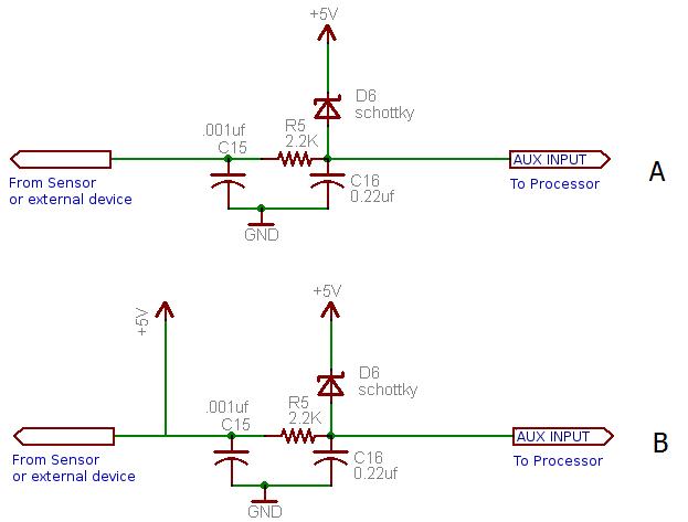

Got all the bits from my "junk" and some old stock at work and followed the schematic above (see page 3 of this thread)... all parts should be available off the shelf at Maplins... not sure quitewhat the jack socket is... just found it knocking about at work and came up with the idea of using it as the input. I think it came from Rapid, but I don't have a part number.

Hi Guys could you just confirm something for me...
im trying this out with a 0-5v sensor, but im a tiny bit confused on the bit that says "omit R6 is using a 0-5v signal" can you tell me which one of these are right?
pretty sure its a but can you confirm?
Go with circuit A. Since your sensor outputs a voltage for the 'Jolt to interpret, you don't need the +5v OR R6 to act as a voltage divider when using a variable resistance sensor like a temp sensor.

Thats the thoughts I had, thanks for confirming it. we will give it a go tomorrow :)
