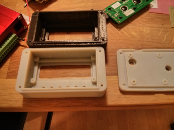

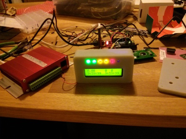

- The new and old enclosures, side-by-side
- IMG_20140323_204448.jpg (54.5 KiB) Viewed 15916 times
- New enclosure with electronics inserted
- IMG_20140323_204216.jpg (67.67 KiB) Viewed 15916 times
- New enclosure, side view.
- IMG_20140323_204522.jpg (92.92 KiB) Viewed 15916 times

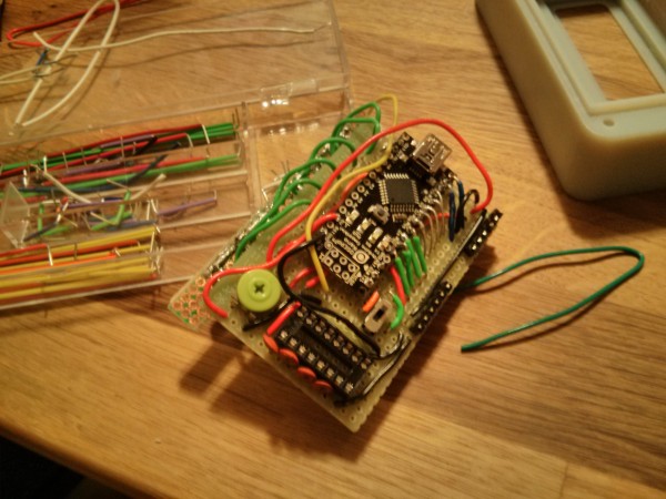

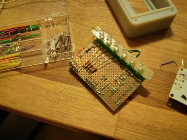

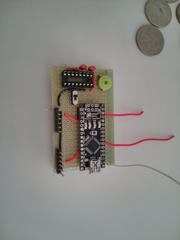

- Circuit board completed
- IMG_20140402_201112.jpg (72.76 KiB) Viewed 15914 times
- circuit board, completed
- IMG_20140402_201103.jpg (71.27 KiB) Viewed 15914 times

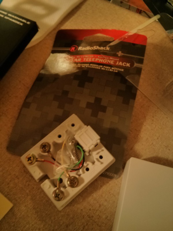

- Solution to my RJ11 connection problem: radioshack RJ11 wall socket. The internal connector pops right out. Each pin has a wire connection.
- IMG_20140403_195832.jpg (73.83 KiB) Viewed 15915 times
Yeah, it is. The solder left-over from the previous iteration definitely made it hard re-use. That's why you see direct wire connections on there. I used just enough header pins to secure the arduino to the board.brentp wrote:Love it! is that the same arduino you were using before?
If I ever have to make another one of these, I'm just going to use the DIP version of the AT328 directly. I've got three of them with the arduino boot-loader loaded. I'm working on a Fritzing project to produce a real PCB.
Meanwhile, I've finally got around to updating the CAD files for the enclosure. I've changed mounting hole diameters to match the correct tap drill size, merged rear cover and the mounting brackets, and relocated the pass-through for the cabling. Having to go to tech shop to do 3D work is definitely a bottle-neck. But for now it's cheaper than buying a license for Inventor or some other CAD program.

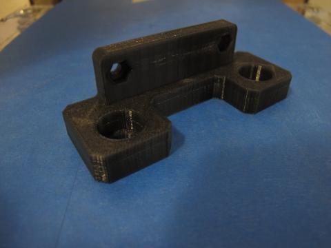

I've been busy relaxing. I put my project a way, cleaned up my apartment. Went to a couple parties, did some pub trivia, kicked some butt at Go Kart Racer, and played with most of the free 3D modeling apps out there -- including one which works on iPad. Fun stuff. Somehow, I found time to design this bracket which will hold the Solo onto the bodywork. The spacing for the mounting screws is compatible with my dashboard design. I'm leaving open the possibility of switching between them.

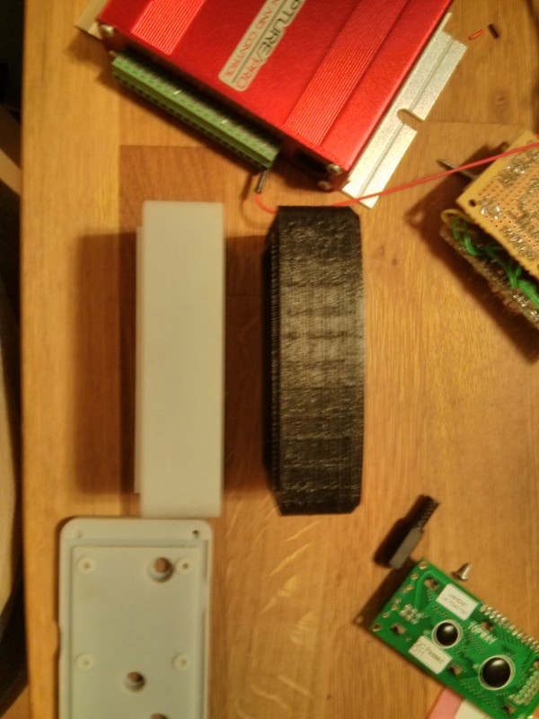

I am still waiting on the enclosure for the dashboard. I'm having my print new parts (in CLEAR resin!), but he missed his chance to jump on the machine this week. It might be a blessing, though. I'm getting better at this CAD stuff, and I think I might want to do things a little differently.
