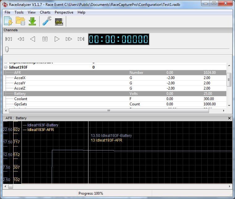

There seems to be a glitch or bug in how the decimal places/precision are displayed in the line chart display of data.

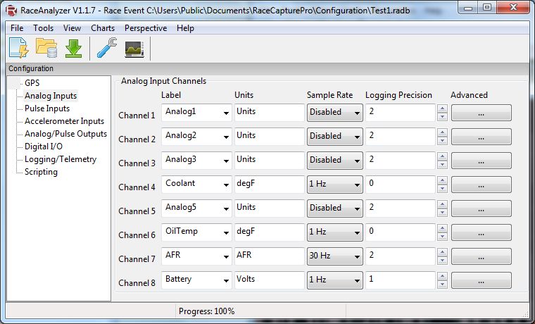

I selected 1 decimal place of precision for battery voltage, and two for AFR. The logfile itself is correct. The line chart display is not. For some reason the line chart shows 0 precision for AFR and 2 for Battery.
Thanks for the note. I believe there is currently a decoupling between the firmware configuration and what is displayed in the application. Originally this was by design, but it's worth re-investigating as it's not immediately clear why that was.
We'll get it on the list! Thanks for all of your testing!
