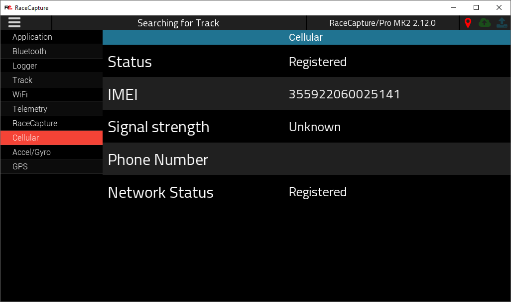

MK2 with 3.5G card, lastest FW and App. All worked well over a year ago with ATT. Fast forward to last month stopped working. Went to a Freedom Pop SIM same thing. Registered on the network no signal. Same for both ATT & FP. Spent two hours on the phone with no beans. They stated the SIMs are activated on their networks neither cannot see my device.
- RCP cell error
- image.png (55.3 KiB) Viewed 10464 times
Hi, From your screenshot it looks like it's connected.
A couple of things to check:
* Do you see a flashing telemetry LED?
* Watch the RaceCapture log for messages about connecting telemetry. You can copy and paste it in a reply here: https://wiki.autosportlabs.com/RaceCapt ... apture_Log
* After the screen shows "Registered" as in your screen shot, do you see an Ad-Hoc event at http://podium.live/home
