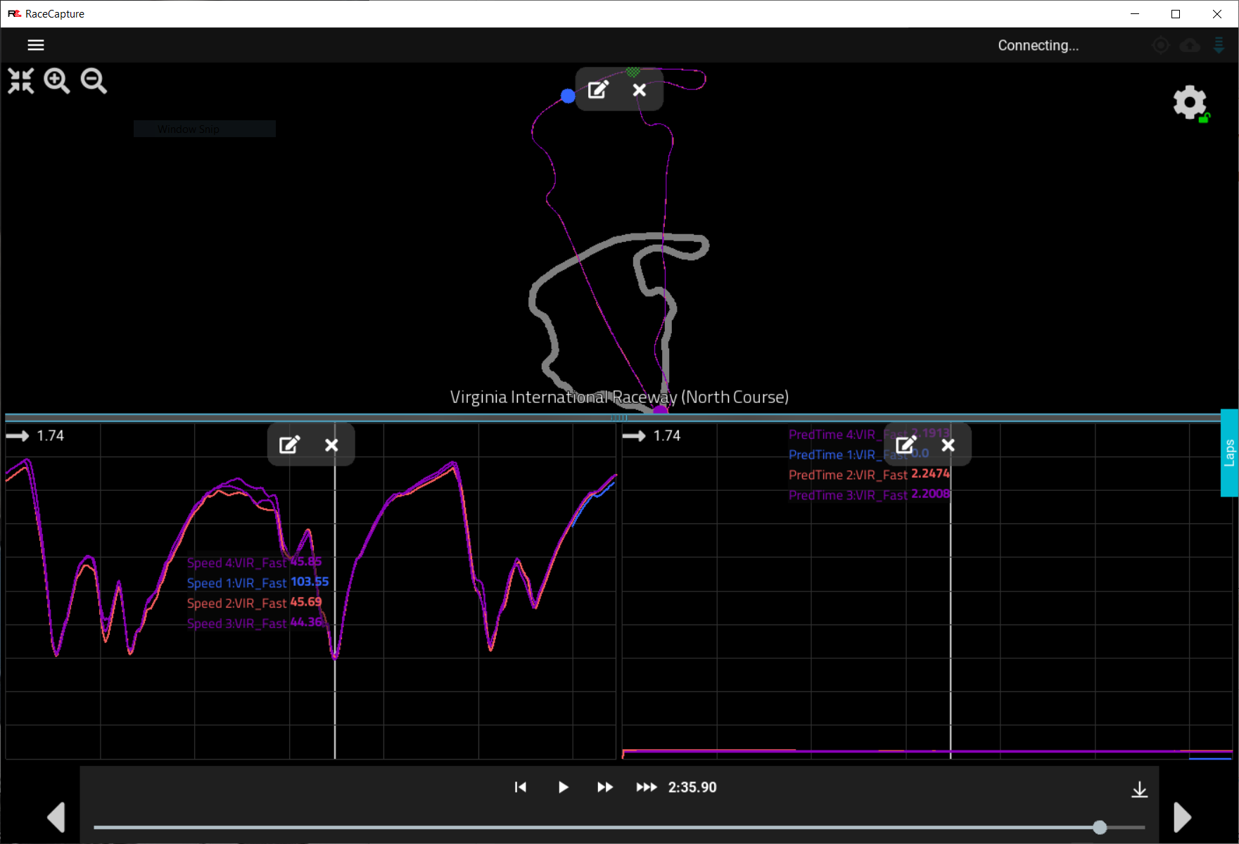

I also have another log from a full session at VIR that shows the trace being not lined up with the track when using the RaceCapture app for review, it's off by about half of the size of the track (lengthwise, not just shifted off-line a bit). That log is too large to upload apparently though, I have attached a screen shot to show what I mean:
