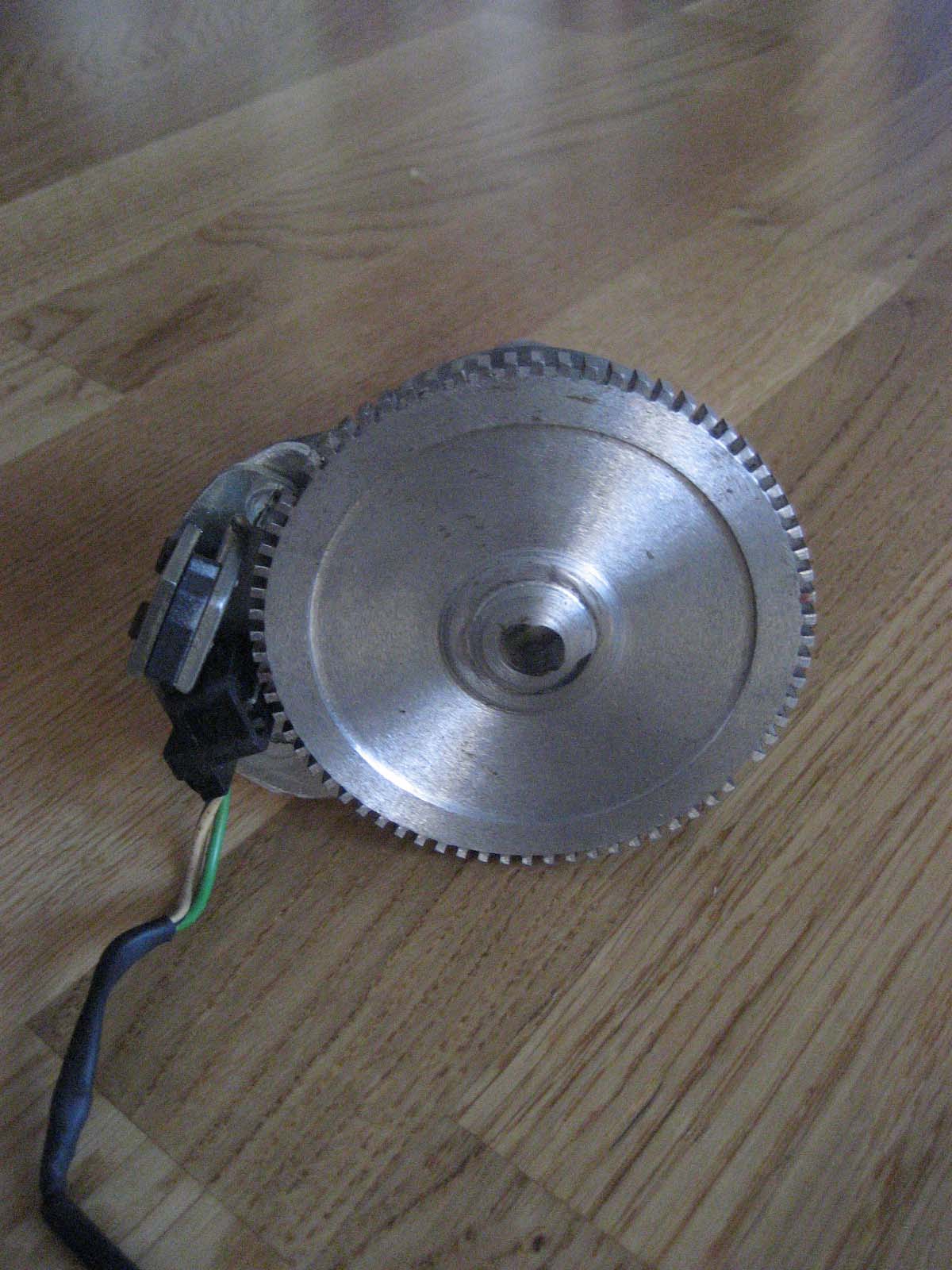

third image

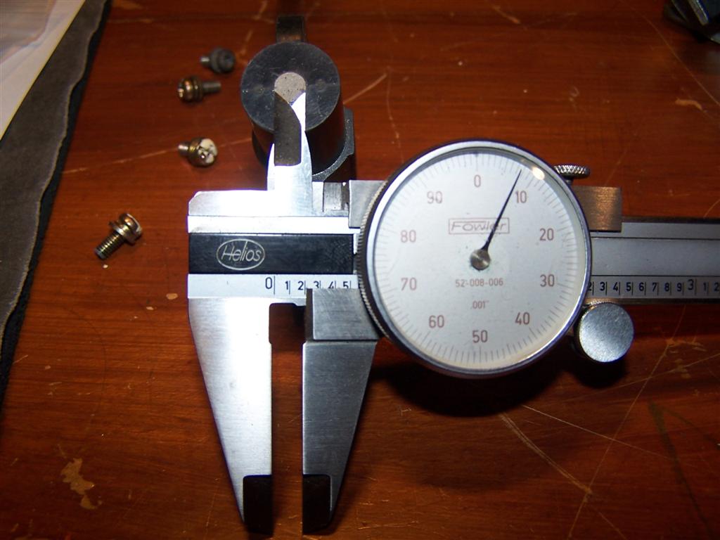

First off Ford VR sensor measurements:

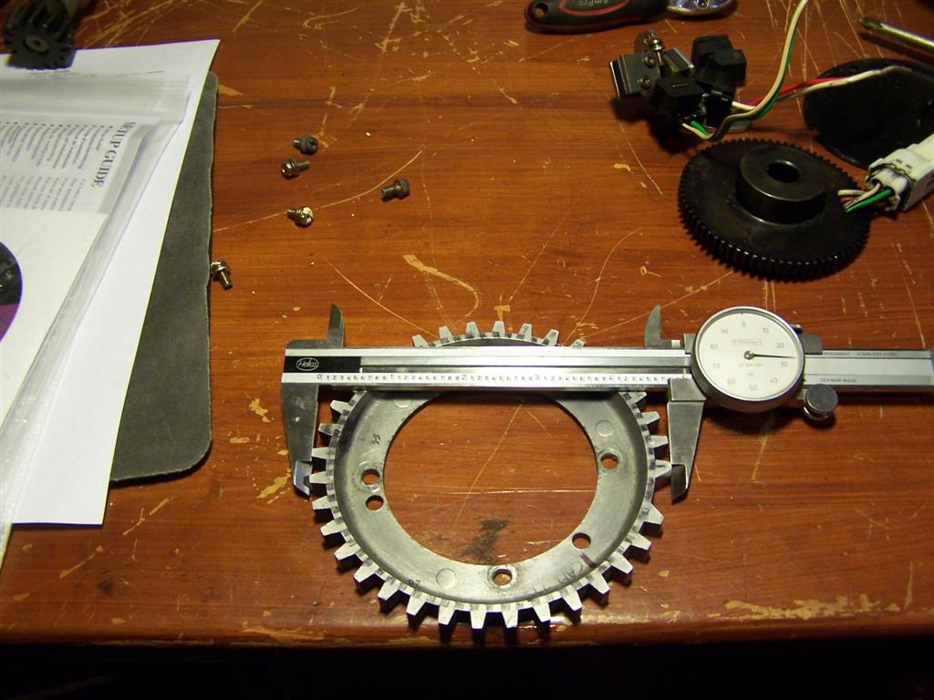

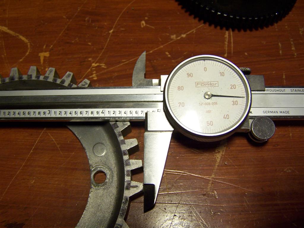

Next up Ford Trigger Wheel Measurements:
Respectfully
Dean

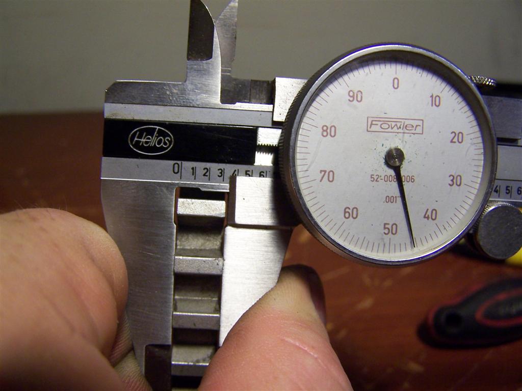

Rx7 sensor measurements

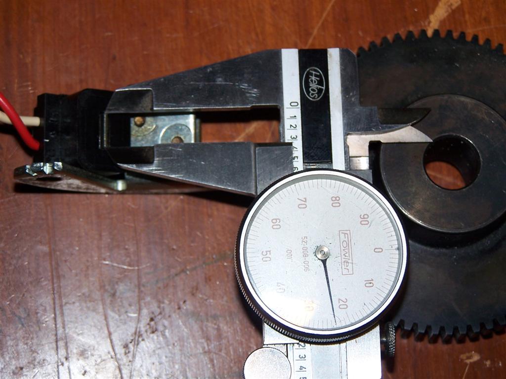

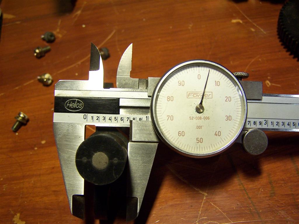

RX7 sensor measurement of the actual pickup.
Respectfully
Dean

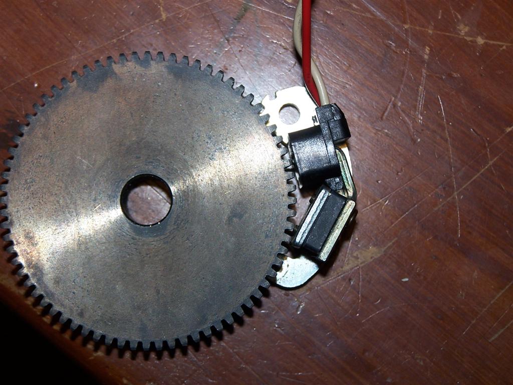

Standard unmodified sensor against the trigger wheel. Note the tight clearance to the magnet. This is about as large as wheel you can use with an unmodified RX7 sensor
Respectfully
Dean

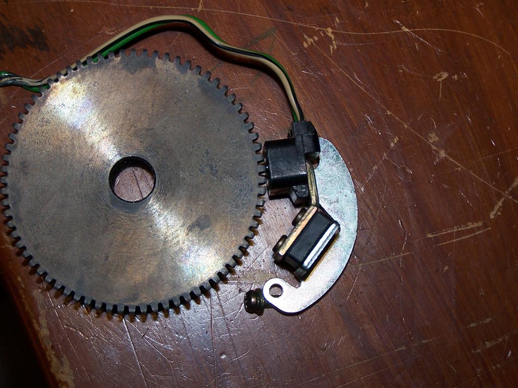

Now the modified sensor Note the additional clearance
Respectfully
Dean

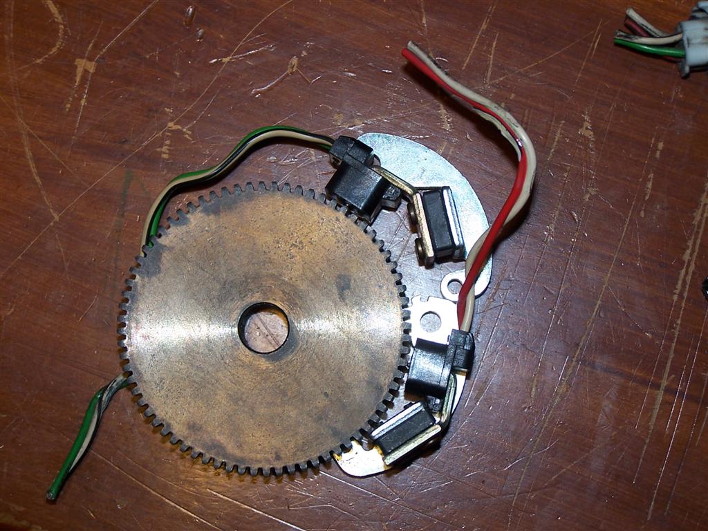

And finally the two together showing the difference in the clearance.
Respectfully
