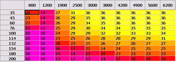

I have attached my current map, we have increased the off boost advance to try and tune the problem out.. I might try some copper pipe around the dashpot to the heater pipes to see if this helps..
- map.JPG (38.75 KiB) Viewed 5702 times
