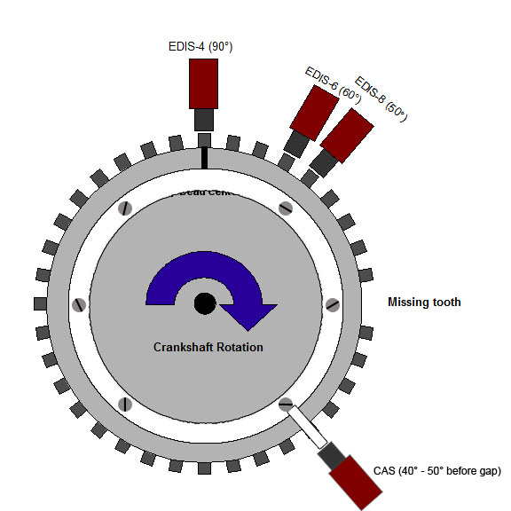

brentp wrote:Right- that would give you the extra signal. A much more custom option would be to sense right off the crankshaft, or off the end of one of the timing gears.
what could work then would be to affix another trigger wheel w/ a single tooth atop the existing 36-1 trigger wheel but align the tooth 4 or 5 teeth before the missing tooth like in the image attached. one could always just bolt in a single tooth using 2 bolts to place a stationary longer tooth in the proper location.

Sorry, I mis-spoke- I meant camshaft. Since you're trying to determine if the cylinder is in the compression stroke or exhaust stroke, you have to sense from the camshaft, which runs at 1/2 crankshaft speed.

brentp wrote:Sorry, I mis-spoke- I meant camshaft. Since you're trying to determine if the cylinder is in the compression stroke or exhaust stroke, you have to sense from the camshaft, which runs at 1/2 crankshaft speed.
doh! :oops:
