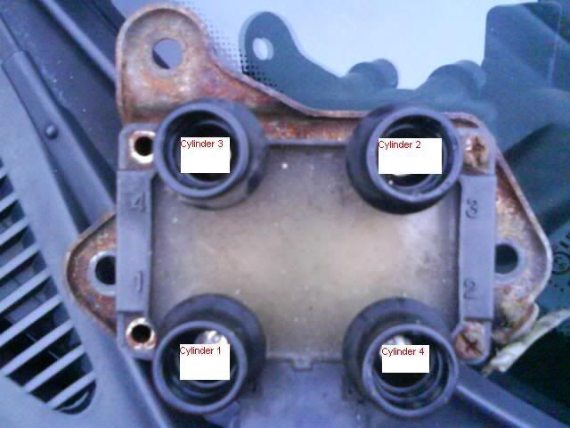

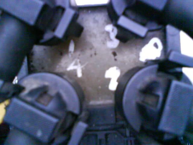

Well the numbers on the coilpack,I thought they were there for reference to place the HT leads to the correct cylinder. For example,1 on the coilpack goes to cylinder 1,which is correct anyway. Number 2 on the coilpack I placed onto cylinder 2,3 on the coilpack I placed onto cylinder 3 and 4 onto cylinder 4 :roll:
The firing order on my Sierra is 1-3-4-2,hoping I have this correct,I have written in the terminals the order I have placed the HT leads.
I have two coilpacks,and one of them does not have the numbers on. So what I had done sometime ago,was copied the sequence on this one
I've used tipex correction fluid to mark the coiImagelpack.
What baffles me is,in the top picture it has the numbers on the coilpack,4 is at the top,1 is at the bottom

They can be interchanged. They both fire at the same time so the number don't really matter. Think it as two coils each with two terminals. I suspect that the numbers are there for Te routing of the wires on what ever motor they cam off of.
Take a look here
http://www.autosportlabs.org/viewtopic. ... c&start=15
I have photos of two coils that are labeled in revers as well. The one in the photo that you posted looks exactly Ike the one I got form a 1997 contour where as the 1994 escort coil has the 1 and the 4 reversed. The bigger and more important thing to note is that the plugs are different so what e use try to note what car it came from so if it dies you can get another one from the parts store if needed.

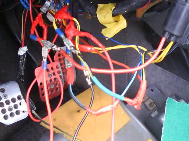

Right,I've had another bash at it today to get my Sierra running,and with the help of my neighbour,it is up and running. But bloody'ell! What a commotion when getting it to run. Take into account I'm using a DGAV carb.
Firstly,the wires from the igntion barrel are split due an attempted theft,which I have used to the advantage of having an external means of cranking the engine over...
...instead of the key in the ignition,so I can see if there is a spark from a plug in the engine bay,against an earth point. So far so good,I'm getting the spark. But,when I try to fire up via the key in the ignition,I get no spark Image
Next is where my helpful neighbour assisted (not forgetting to mention that he has been helpful in the past,when hunting for a spark) who suggested cranking the engine from the starter motor...hmmm,I'm thinking,not too sure about that,as I am somewhat sceptical/cautious when around live feed,easily spooked :D . Eventually I thought I'll give it a try with a long screwdriver. The first crank scared the living daylights out of me :D Eventually I felt comfortable in doing it. After so many attempts to get it running,alot of spluttering,coughing and flames thrown out of the carb,it eventually ranImage
But I can't grasp why it won't spark on the key. Suggestions most appreciated,thanks

Probably due to my explanation,it has misled you. The starter does spin via the ignition key. I'm going to opt in changing the live feed leading from the edis and MJ from the accessories wire (solid yellow) to a different ignition wire.

That have you tried temporarily linking out the +12V feed direct from the battery? Quite often "accessory" power in switched off while the engine is cranking - exactly when you want a spark.

Gilesy998 wrote:That have you tried temporarily linking out the +12V feed direct from the battery? Quite often "accessory" power in switched off while the engine is cranking - exactly when you want a spark.
yeah...that's what I'm thinking. Just like on a radio headset,it goes off when cranking. Well here's a vid of it running
