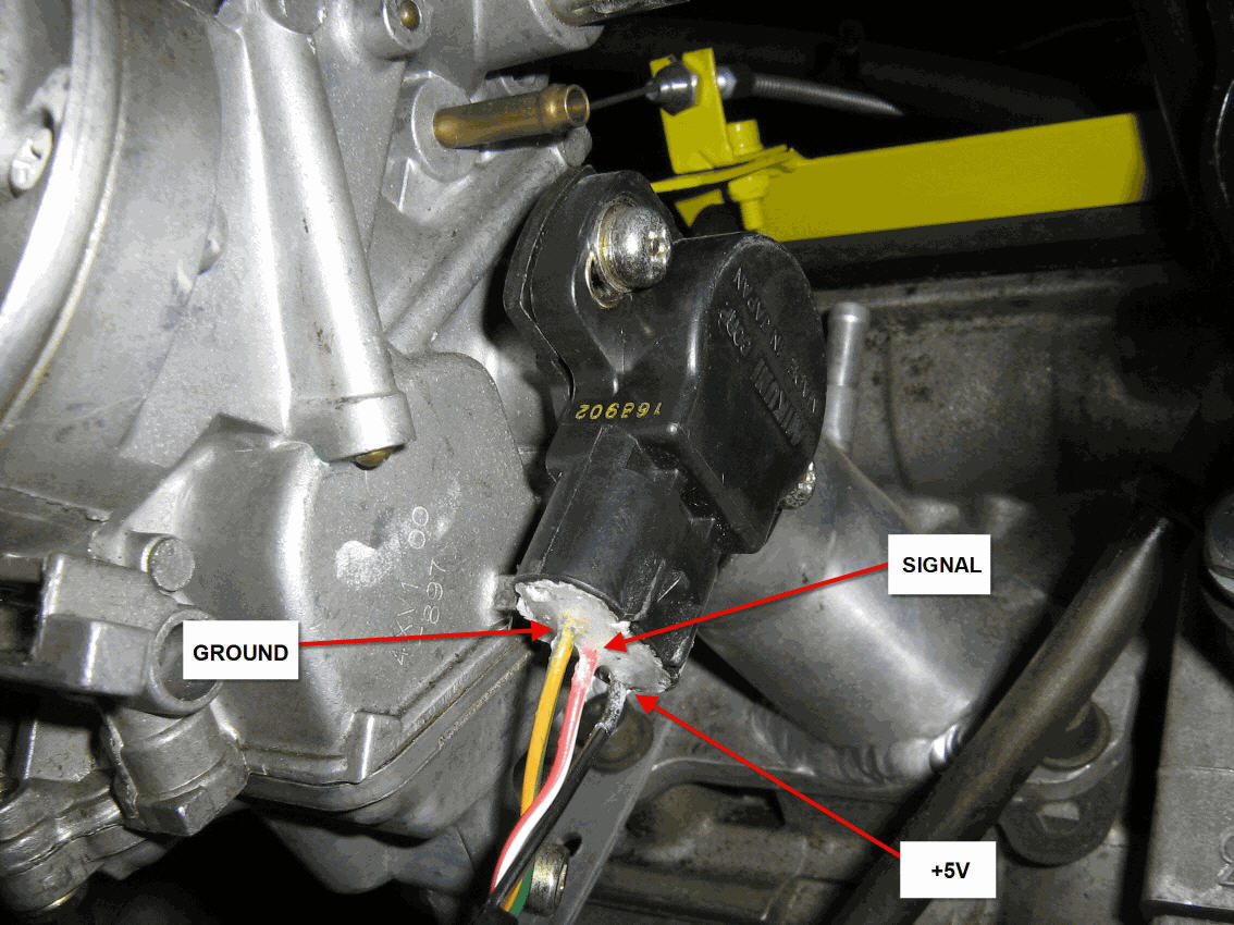

ORB - I hope this helps you out
Hi Orb,
I seem to have been having a bit of trouble posting back to you???
Hope the attachment comes through this time.
Left - Connected to ground
Middle - Should go to "TPS INPUT" on the megajolt plug
Right - +5V reference voltage
If you need more help, I'll see what I can do.
- Throttle Pot Wiring for Yamaha R1
- R1_POT_WIRING.jpg (160.67 KiB) Viewed 30032 times

Thats awesome thanks!
Sorry for the delay in replying, I have been on hols for a week!
When you say the wire goes to Ground, do you mean Megajolt Ground or to the chassis?

Re: R1 Loom/carbs/TPS help
Hi there,
Ideally it should be grounded/eathed the same earth point as you earth the megajolt, edis module etc.
Must admit though mine is earthed to the engine, at the same place the chassis is eathed to the engine.
