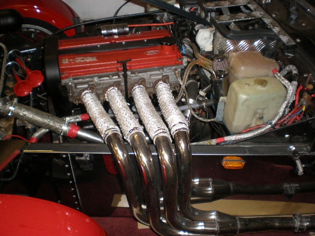

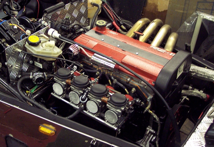

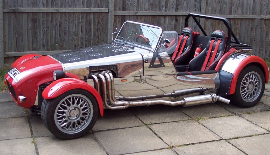

These pics are of my Robin Hood 2B shortly after carrying out the conversion to 1.8 Zetec. I am running 4 x bike carbs, on a home made manifold, and ignition by Megajolt.

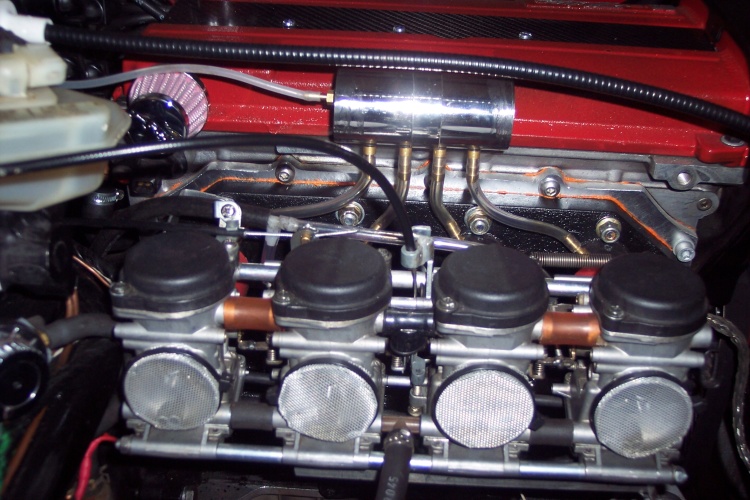

I am running the Map option, with a threaded take off into each inlet tract, with four individual pipes into the balance plenum (which is in fact an old piece of exhaust pipe, polished to a good shine)

That's a very nice looking installation, I'm very jelous of the vacuum plenum, mine is currently cobbled together from plumbing supplies from Homebase!
One thing I did notice is the gause over the carb mouths, whilst this will keep out the larger debris it won't keep out the smaller stuff and it does really horrible things to the airflow capability according to Vizard. If you replace that with a good air filter I bet you will immediately notice a big difference.

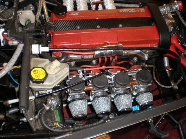

Thanks for the kind comments on my Zetec conversion, I must admit I'm very pleased with the results. I will post a couple of new pics over the weekend, showing the new air filters, and the MJ location.
Zetec conv.

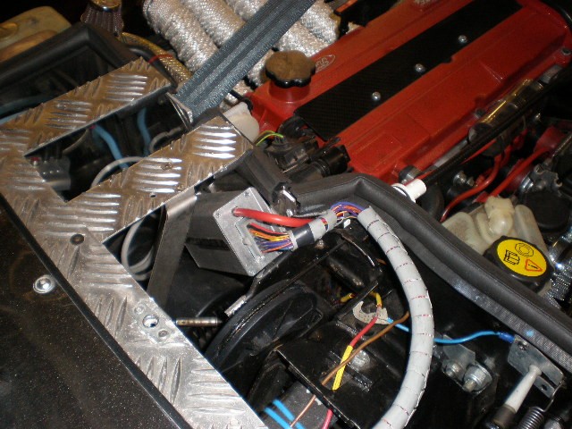

As promised a few new pics - proper air filters now fitted to carbs. MJLJ comfortably located on cabin side of bulkhead, and mounted on the same fixings as the coil pack
