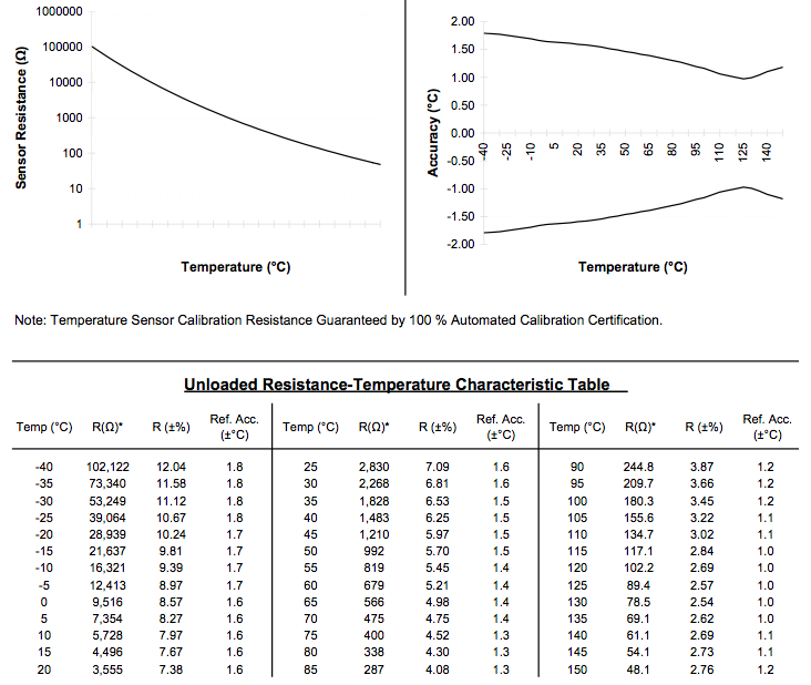

Post by BRUCEROE »
There is a very common & cheap 2 wire temp sensor used for EFI in all kinds of liquid cooled engines. It came with my EDIS parts. I'm attaching the resistance chart (degrees C). If you use it in MJLJ setup, it will be powered by 5V through 2.2K ohms. I have a file from my unit which translates Aux input voltage to Degrees F. Bruce Roe
