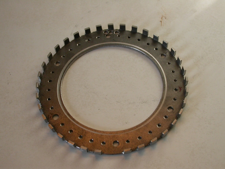

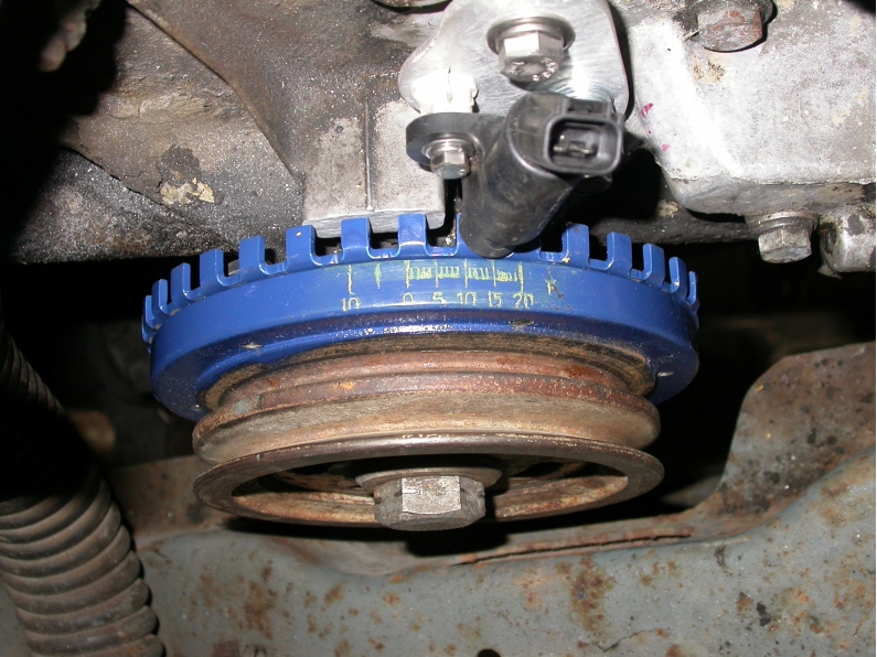

Because I'm crazy, I decided to make my own triggerwheel and attach it to the back of the harmonic balancer on our '65 Jeep engine. Having the trigger on the back of the balancer means there is no interferance with the front cross member that is very close. I'm coming up to the wiring stage - wish me luck!
Pavel in BC
wheel bolted to the harmonic balancer at the back. This will allow easy belt changes
wheel in place.jpg (232.16 KiB) Viewed 15501 times
homemade 12 gauge steel 36-1...too much work

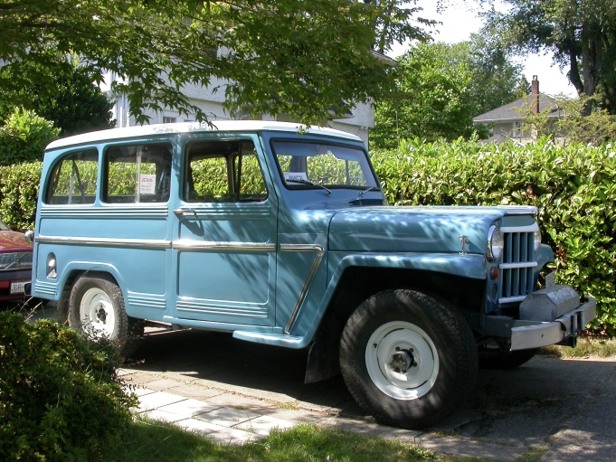

Here's the Jeep in all her splendor
What a beauty!
What a beauty!
Willys wagon.jpg (244.24 KiB) Viewed 15498 times
I like the triggerwheel, looks like an excellent home made job to me. Are you in some sort of engineering trade , it looks excellent.
Liking the Jeep too, not totally my taste but looks different which i like. It kind of a cross between a landrover, morris traveller with some london taxi cab rear wheel arches. Very different. And the opposing windscreen wipers are ace, do they have seperate motors or are they linked together???

You are very kind to ask about my possible engineering background but sorry, I was a high school Biology teacher for 27 years! I'm just a tinkerer and we'll see if the trigger wheel works...
Yes, the old Willys was not totally to my taste either - I'm more a large and small Healey, Volvo guy. But the funny thing is the Willys has really grown on me - something about its lumbering primitiveness, it has a certain charm. The wipers are vacuum controlled (hope that won't influence the MAP sensor in the MJLJ negatively) and are hooked together with pulleys and cable drive - even more useless than the old Lucas wipers.
