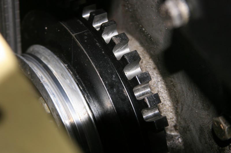

Here is a shot of the dampner with the teeth cut into it, the dampner was rebuilt, teeth cut into it and then balanced.
11__copy 0276.jpg (83.1 KiB) Viewed 7899 times

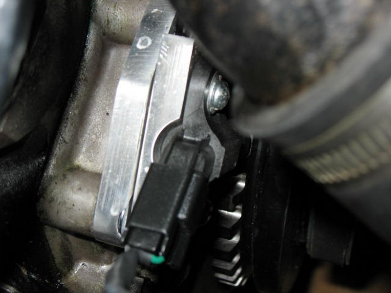

A shot of the magnetic sensor mounted on the timing cover pointing to the dampner, clearence is.053 no adjustment built into the attachment block.
11__copy 0262.jpg (81.52 KiB) Viewed 7899 times
