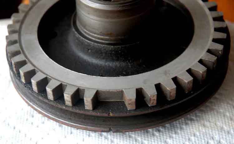

The 36-1 Trigger wheel that i have is smaller than my pulley. The teeth are just short of the edge of the pulley.
Do the teeth have to be proud of the pulley? Will i get interference from the pulley edge running along side
the teeth? (pulley is for a 1500 Spitfire) Thanks for any help! :?:
The teeth are 3/8'' wide. I have added a photo, thanks
Finally re-sized the photo correctly...

No you wont so long as you strategically place the VR sensor so it is covered by the majority of the triggerwheels teeth. What is the thickness of the triggerwheel???
