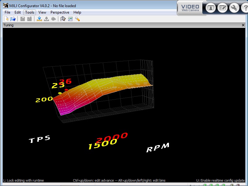

I have attached a screen shot of my tuning page on the megajolt I am using but think I am missing a feature and it seems to be software related.
I'm assuming there should be a number in red next to the TPS bit which would come towards you when you press the throttle. I did this with the engine running, but nothing seems to happen in red. The TPS meter on the front page moves up and down with the rpm but on the tuning page nothing seems to happen.
http://www.autosportlabs.net/Image:Mjlj ... g_view.png
If you look at the link there is a '100' where I would have thought theTtPS would register? It's coming up on the graph in the runtime view OK just not the tuning view.
Can you maybe shed some light on how this function and maybe where mine is not?

Can you double-check this *with the engine running*? With the engine not running, the TPS / Load gauge will respond to changes, but the currently active bin will not change.
Also, do you see an RPM reading while the engine is running?
Let us know what you find out.

The TPS gauge goes from 0-100 when the ignition is on but no engine.
The RPM also works when the engine is on.
