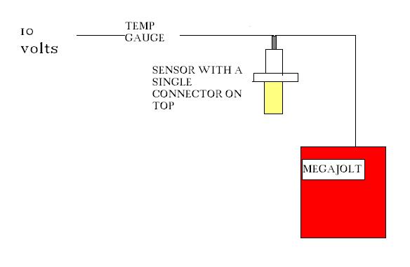

Hi guys, cheers for replies, I have a one wire type sensor and it is already in use, its powered down from 12v to 10v by a voltage regulator (thats what I meant by 12v sensor)
So would it be ok if I connect the aux input wire to the temp sensor aswell like below?
Thanks, Rich

That would NOT be OK, for a couple of reasons. The 2.2K resistor in the MKLJ would throw off your present circuit. Even if the 2.2K were disconnected, it is likely your present circuit sometimes exceeds 5 volts at the sensor. The MJLJ can't be calibrated outside of 0 to 5 volts. But connecting a second EFI style temp sensor to the MJLJ would solve the problem. You would still need to enter a calibration chart into the MJLJ for a degrees readout, but I have made one available for degrees F. Bruce Roe

Thats what I wasnt sure about. I'll plumb in another water temp sensor somewhere and put the megajolt to that.. If I find that the sensor in the pic above does only recieve 5v max from the gauge I could still use it then couldnt I? but oly if it revieves 5v MAX!!
At the moment my aux input temp gauge is shownig the ADC value as the temp reading, by recalibrating it, you mean change the ADC value to degrees F or C so it shows as the degrees equilavant of the voltage reading on the gauge instead of the current ADC value? Whats the scaled value section for?

If you use your present sensor (which NEVER exceeds 5V), you will have to measure the voltage and temperature (trust your original gauge?) over the operating range. Then make a conversion table for the MJLJ. Without a conversion chart the MJLJ gauge will apparently be reading backward. And disconnect the 2.2K resistor.
This is quite a project, that's why I suggest just simply adding a standard sensor & loading an existing table. I'll need to look up the sensor data sheet, from which I did a conversion chart. The sensor isn't linear with temperature, but resistance vs temp is on its data sheet. The resulting voltage with 5V applied to the 2.2K resistor can be calculated. Those voltages then make a table that the MJLJ translates from voltage input to degrees F at the on screen gauge. Guess you could do degrees C, but I believe the range of the readout is presently limited to 0 to 255. Bruce

BRUCEROE wrote:That would NOT be OK, for a couple of reasons. The 2.2K resistor in the MKLJ would throw off your present circuit. Even if the 2.2K were disconnected, it is likely your present circuit sometimes exceeds 5 volts at the sensor. The MJLJ can't be calibrated outside of 0 to 5 volts. But connecting a second EFI style temp sensor to the MJLJ would solve the problem. You would still need to enter a calibration chart into the MJLJ for a degrees readout, but I have made one available for degrees F. Bruce Roe
How about adding a simple high resistance voltage divider (e.g. 14K/10K) to the Megajolts Aux input, which lowers the output from the temperature sensor to a safe 0-5V TTL signal? That shouldnt interfere with the Temperature Gauge (at least not more than 5-10%, which you wouldn't notice on the 240Z gauge anyway) and you could leave the factory temperature sensor and gauge in place.

That will work. But then there is still the problem of generating a calibration chart for the original gauge-sensor combination, how do you do that? Also, 12V to the gauge varies a lot from say, idle with lights on, to full speed no load. That voltage variation will cause the MJLJ gauge to change every time you step on the gas, because the MJLJ reference voltage is fixed. The original gauge probably has compensating circuitry.
A divider with high enough impedance to not affect the original circuit, will not be able to drive much voltage into the 2.2K MJLJ pullup resistor. So the 2.2K will need to be disconnected for decent resolution. Not needed for separate sensor.

Voltage variation is a good point, i am just trying to avoid to drill a hole in my engine block. I guess i'll have a look at the gauge itself, there might be a chance to get a voltage output after the line regulator.
