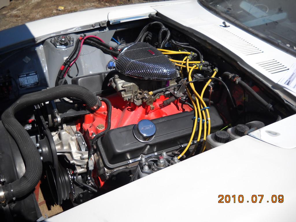

Here are some pics of my Z-car. It has not been running long and still needs to be fully sorted.
It is a 74 Datsun 260Z that has got a chevy small block/ T-56 combination.
400 block/327 crank=352 C.I. screamer. WOOHOOO!! LOL!
All Forged, all Roller.
I am still trying to develope an advance curve for this. I Hope I can find a step by step "how to".
Anyway heres the pics.

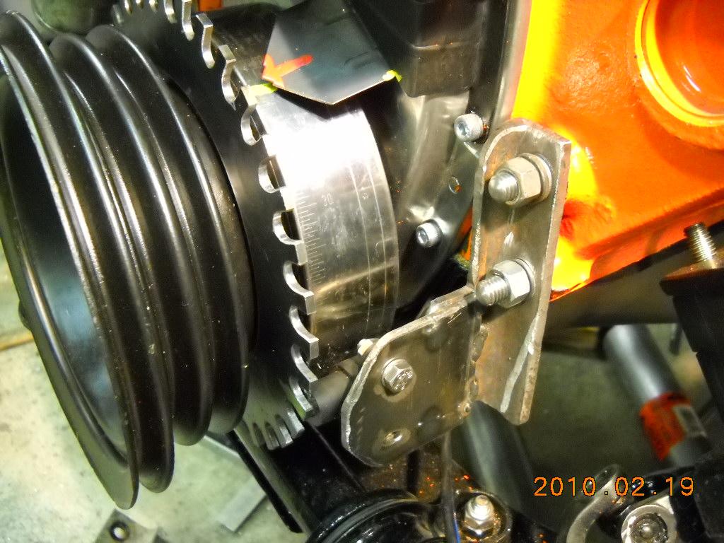

Pic of my trigger wheel. Made out of an old flex plate and a piece of 10 gauge sheet.

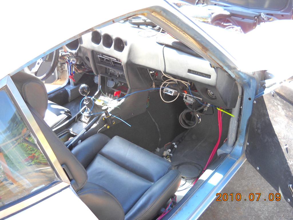

passenger side showing position of MJLJr. unit.
Interior- exterior 014-1.JPG (138.96 KiB) Viewed 6149 times
