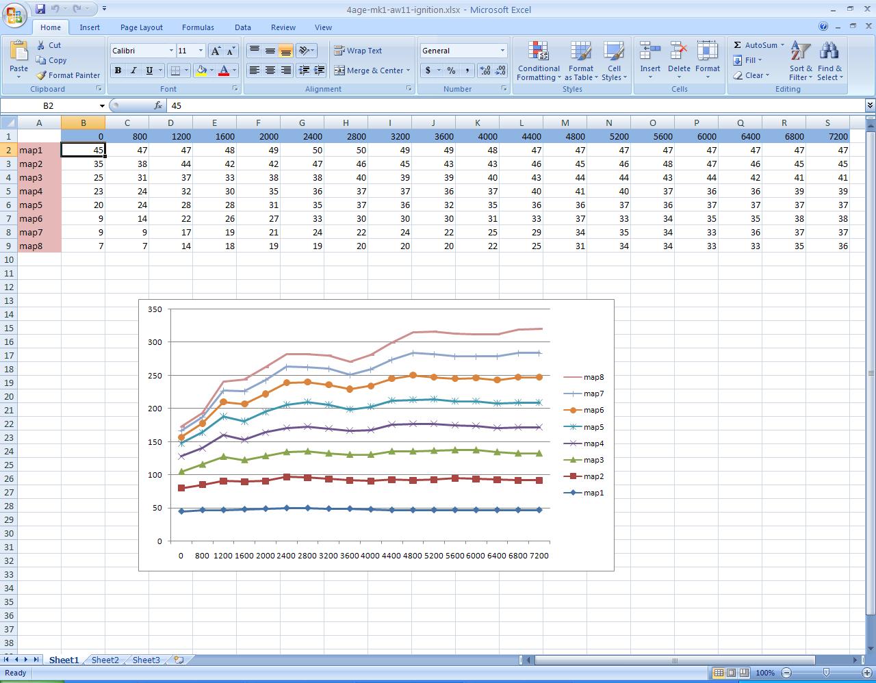

Any chance of getting a little more resolution in the near future? What I have in mind is possibly getting at least a total of 18 columns of rpm detail.
The megajolt2 family is currently slated to support a 12x12 map- but this was picked arbitrarily and can be changed. How would a bigger map make things better- specific example? Should it be a square map, or one rectangular, with a greater emphasis on RPM bins? Remember too, you can change the bin bucket values, providing finer grained resolution in certain areas of the map.
my reasoning is actually pretty simple minded. i've mapped out as best i can the aw11 ecu ignition table from jeremy ross' work and uses 18 columns of rpm resolution. i wanted to emulate it and tweak the timing table for my hi-comp setup.
the timing tables show interesting dips at various spots with slight differences among the 8 map lines.
Interesting. with the 32 bit processor and ample RAM / Flash the limit of the ignition map is more of a human management issue (so many numbers to edit). I think some software tools to edit / smooth / manage ranges of the the map could help alleviate that. Also, I wonder if the AW11 ECU does interpolation between bins?

according to Jeremy Ross' findings, the AW11 ecu DOES interpolate between the various ignition maps based on several conditions received from its sensors.brentp wrote:Interesting. with the 32 bit processor and ample RAM / Flash the limit of the ignition map is more of a human management issue (so many numbers to edit). I think some software tools to edit / smooth / manage ranges of the the map could help alleviate that. Also, I wonder if the AW11 ECU does interpolation between bins?
i've attached an excel file of the aw11 ignition map based on the extracted info from the factory MAP ecu.
- 4AGE-AW11-IGNT.JPG (199.76 KiB) Viewed 14025 times
