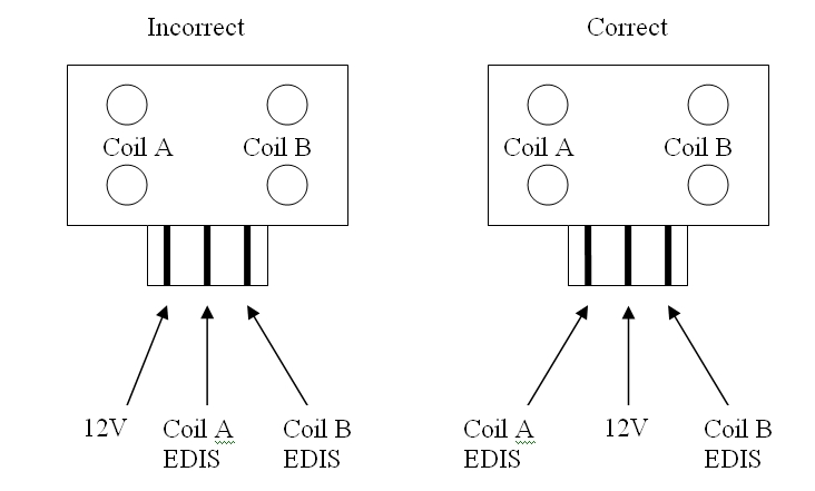

discovered something very odd tonight that may be related to the above - it was discovered while tracking down a misfire under load. Turned out the posts in my coil pack are almost completely corroded away
anyway...
I put a timing on each of the 4 spark plug leads, and there is a very obvious difference in the number of pulses through the spark plug leads for #1 and #2 to the number of pulses for #3 and #4. It looks like #1&2 get double the pulses for #3&4
I installed a known good coil pack - same thing
I'll see if I can get a graph of it through an oscilloscope
Again this sounds like to me that the wiring to the coil pack is incorrect.
If you have the 12v power lead to the coil pack is attached to the incorrect pin then as (for instance) coil A output of the EDIS fires you get a good spark from oneside of the coil pack, but then Coil B output fires you have a weaker speaker form both sides of the coil pack

NITROPIXIE wrote:Again this sounds like to me that the wiring to the coil pack is incorrect.
nup, I don't think I could do 110mph (n/a) with the coil pack configured like that... all 4 plugs are the same colour and have the same mixture indications, and today with a different coil pack, it's back to very impressive performance, but still odd-sparking
but to clarify, I went and checked my wiring - my 12v goes to the middle wire
could you do the same with your timing light? just to see
Try and turn around the lead on your timing light, it is inductive correct? Sometimes the lights behave funny with EDIS. If reversal doesn't work, get an old hardwired style and try that.
simon k
Posts: 14
Joined: Sat Jul 17, 2010 7:57 am
Location: australia
Post by simon k »
DannyP wrote:Try and turn around the lead on your timing light, it is inductive correct? Sometimes the lights behave funny with EDIS. If reversal doesn't work, get an old hardwired style and try that.
yes inductive, and no, it's not that... just with messing around and picking up whichever timing light was in the top of the drawer, it's actually had 3 timing lights on it - scratch that, 4 timing lights, we put it on the analyser too, but the secondary pickups on my mates machine wasn't working which is a bugger, it looks at all 4 plugs at the same time
messing around yesterday I swapped leads around (no, it's not that) and also swapped the pairs over (1=3, 3=1, 2=4, 4=2) and the issue stays with the coil pack post
it'd be really good if someone would pick up their timing light and give it a shot - it honestly takes 30 seconds
