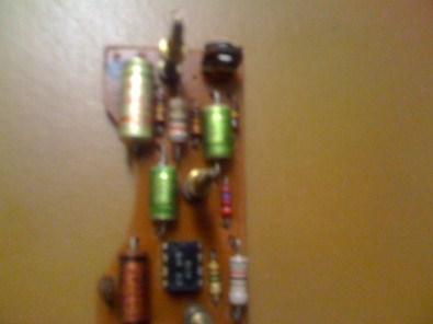

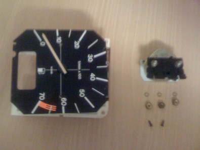

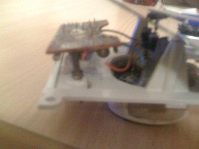

So first of all I disassembled the tacho to get to the tacho driver board (first 2 pictures). The tacho driver board (3rd picture) uses a SAK215 chip to control the rev counter, which is basically a current meter. After a bit of research I found the chip which is used http://www.datasheetarchive.com/SAK215-datasheet.html
I then drew out the circuit board into a circuit diagram to get an understanding of the circuitry, which is fairly similar to that in the datasheet.
Now the hack, I believe if we remove 2 components, namely a resistor and a capacitor and replace the resistor with a link wire, then we should be able to achieve what we wanted and hopefully drive the tacho just using the MJLJ.

So here is the hack,
The red circled component (resistor) is to be replaced with a link. The green circled component (capacitor) is removed. Hopefully this will now make the tacho work with the MJLJ tacho out.
The resistor is a 33K Ohm resistor and there are 2 of them before the signal reaches the chip. This hack may require the second resistor to be reduced in size (not to be removed).
