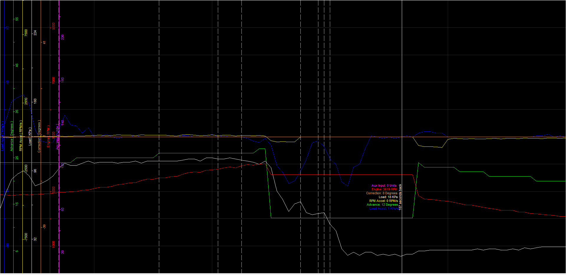

I've been running megajolt for several months now on my mini with no problems whatsoever. Now though it's developed a bit of a backfiring habit. When I'm accelerating hard under load the advance backs all the way off to 12 degrees until I drop the revs whereupon the advance gets back to normal.
I've swapped the coilpack and checked all my grounds, still the same problem. It's weird as the unit has been working fine for several months.

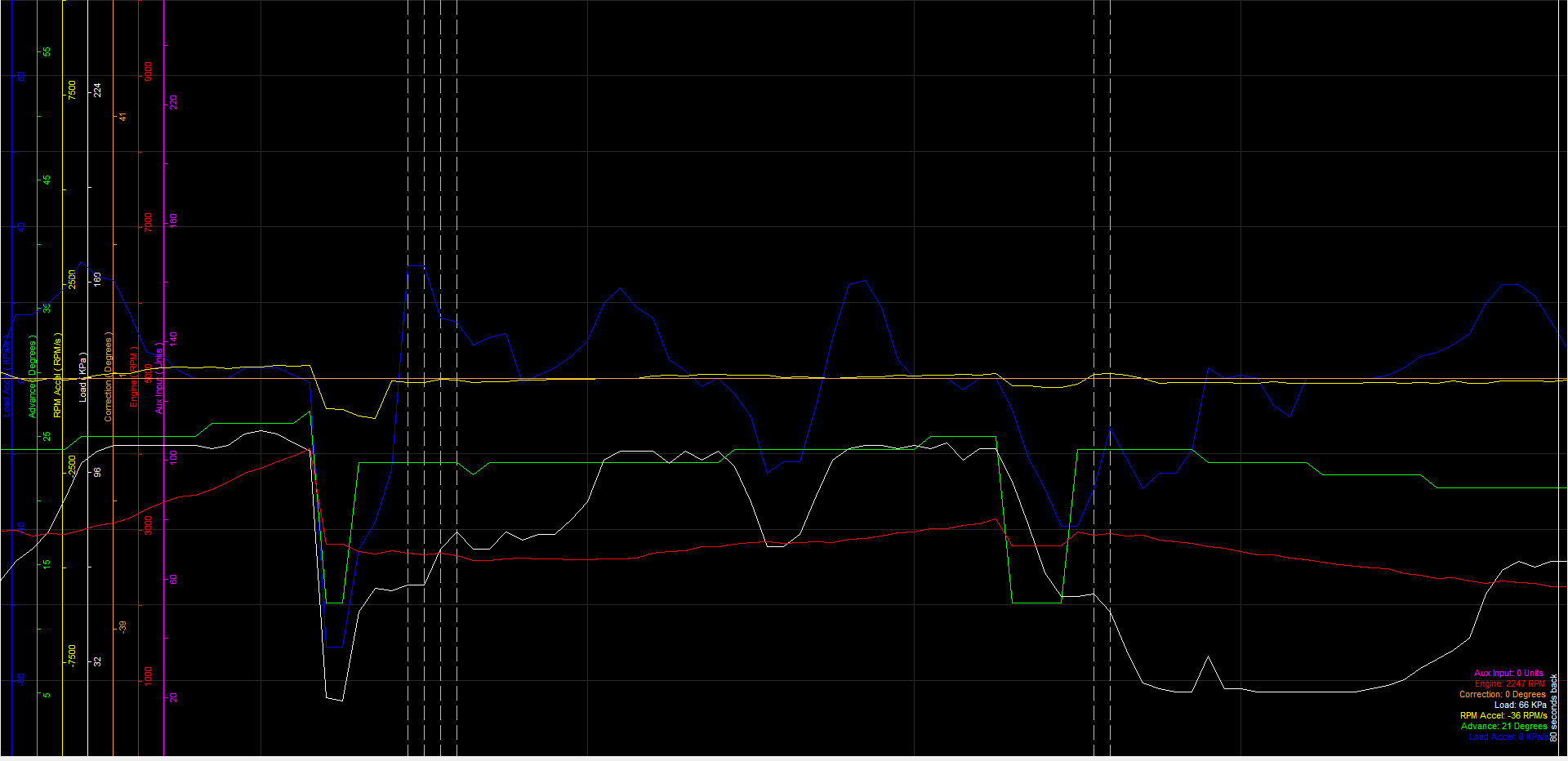

Attached are the two graph files I made - one shows a large "misfire", the other shows two smaller ones. You can clearly see the advance going to 12 degrees and also curiously during this time megajolt isn't registering the revs. The rev counter in the car also dies.

A few possibilities to check here as it's not clear from the logs what is going on.
First can you confirm that you are running resisitive spark plugs - they're usually identified by an 'R' in the part number.
Second check your trigger wheel alignment - your crank sensor needs to be about 0.5-1mm away from the teeth of the trigger wheel on the A-series engine. Whilst you are there check that there is no runout on the wheel, in other words that the gap between teeth and sensor is the same all the way round.
Third check that your crank sensor wiring in particular isn't going past any sources of interference - that means alternator and HT leads. The shielding on the crank sensor cabling needs to be connected to earth at the EDIS module but not connected to anything at the sensor end.
The final possibility is that the issue is on the fuelling side causing the miss. Given the RPM dropoff seen by the ECU it seems unlikely but I have occasionally seen issues like that before where the miss causes the engine to shudder so dramatically that it causes the engine speed signal to drop out.

Hi Toby,
So I presume you're running the diode circuit to bridge the signal between both coil packs?
Since the tach is reading off of the coil packs, a cut-out on the tachometer would indicate the EDIS module is not firing the plugs during the time you're experiencing this problem.
I would say your problem revolves around the crank sensor and it's ability to reliably read the signal from the wheel. Check if something came loose, went out of aligment, etc.
Also, your bracket needs to be very rigid. If it seems to cut out at certain RPMs this could point to a harmonic resonance of the bracket which will affect the signal, causing the EDIS module lose sync with the signal.
