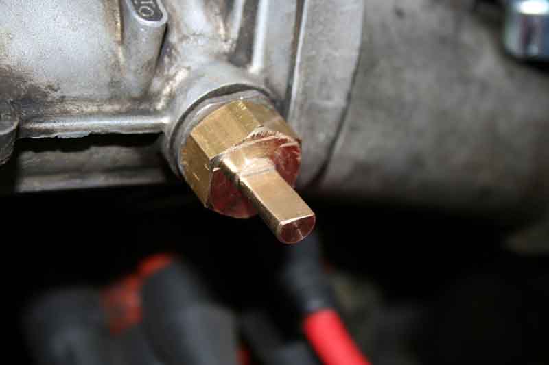

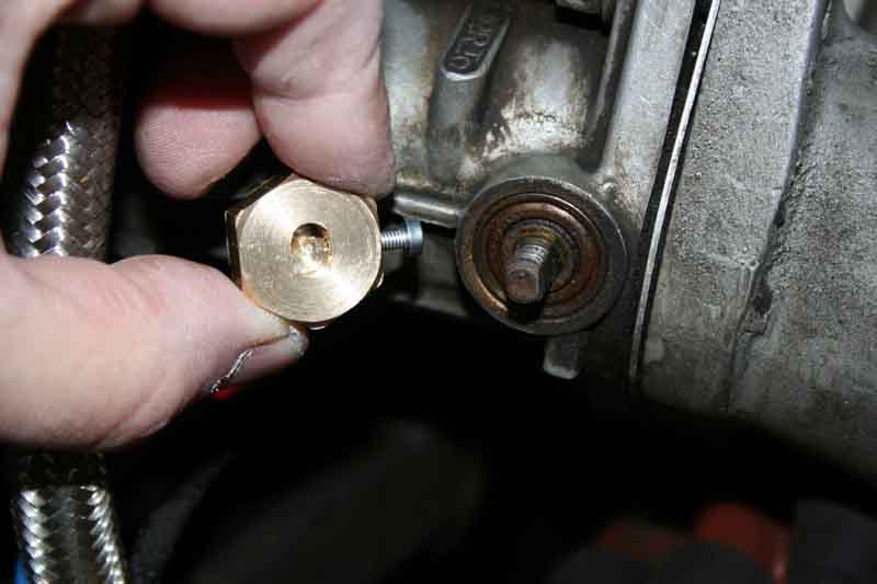

Hello Les,
Here is how I solved it, but you may find ready-made ones (Weber).
Cheers.
Jos
Adapter (selfmade)
Adapter (selfmade)
trial fit
trial fit
