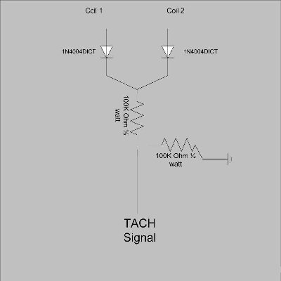

hello Brent,
Tach was efficient for a few weeks but the problem became more consistent over time. but yes..reading is consistently low now.
below is how I did my circuit.
tach diode fix.jpg (9.32 KiB) Viewed 19672 times
73tii
Posts: 4
Joined: Wed Jan 11, 2012 5:28 am
Location: United States
Post by 73tii »
is it possible the diode is shot? anyone?
We're not familiar with that circuit design- it's different than what we have, but it seems that it could work. You might want to check connections on the diodes - if all connections are good it's possible one of the diodes might need replacing. Replace both just to be sure.
Make sure you're using diodes rated for at least 400V - like a 1N4004 or equivalent.
73tii
Posts: 4
Post by 73tii »
found a short in the wiring which subsequently affected the tach to be lazy. All is well now. Thanks Brent.
