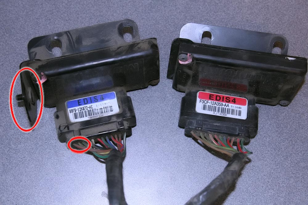

I just got back from my local U-Pull yard where I picked up several different EDIS modules and a coil pack. Can anyone tell me the difference between these 2 EDIS modules? Notice the one with a blue sticker has 1 extra wire and one extra bolt holding it in. They are both Motorcraft and they both came out of a Ford Escort.

For the purposes of use with the Megajolt the EDIS modules are all interchangeable. The extra wire is used on some vehicles for a rev counter feed/diagnostics.
