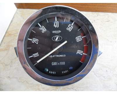

Dear Friends,
this is to ask if my rev counter by Jaeger (see attached picture) can be plugged directly with the megajolt or if it will need the tacho driver proposed by trigger-wheels. Actually I dont know if it is a RVI or a RVC...
Thanks in advance for your help.
cecio
You can try the TACH_OUT on the megajolt first, then the IDM output on the EDIS module, and last you can try the tachometer adapter as you mentioned.
More information in the installation guide here:
http://www.autosportlabs.net/MJLJ_V4_ve ... achometers
