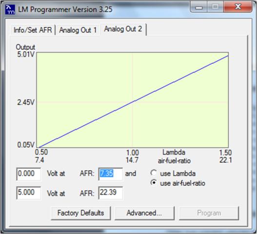

I've noticed that the AFR logged by the RCPro was reading about 0.5AFR higher than what was shown on the DB gauge. Strange, because both are driven by the same analog output from the LC1, according to this transfer curve.

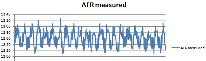

Excel graph of what I was reading from the RCPro. Was about 0.5AFR higher than the gauge. I fed the voltage into another analog input and acquired that as the raw voltage to double check the scaling. No issues with the math conversion between voltage and physical units. I also tried to use the virtual gauge to compare against my multimeter reading, but that wasn't a good comparison method.

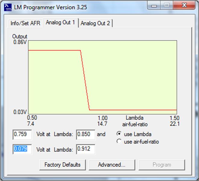

Took another look at how I had the other analog output of the LC1 programmed to fake out the narrow band signal to the engine ECU.
Hmm, my readings should be bouncing between 0.85lambda and 0.912lambda, which is 12.5 and 13.4AFR. Which pretty much agrees with what the RCPro was telling me.
