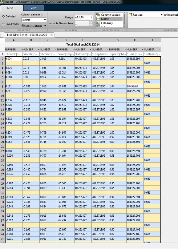

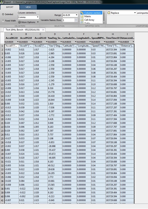

I also seem to be having problems with this (having downloaded and installed the latest software and updated firmware). Additionally, when I go to export the data to Excel, MatLab, etc, I end up with blank cells and clock value repeats if I run any channel above 30Hz, and inconsistent clock intervals no matter what frequency I run at (see attached photos). Do you have any explanation or advice for this?
Evan
Channels run at 30 Hz. Distance limited to 10 Hz by GPS. Look at time in rows 4 and 5, both are XX.906. Additionally, no interval is the same.
30Hz Clock Problem.jpg (217.21 KiB) Viewed 17968 times
All channels run at 10 Hz. See time delta. For first 3 cells is 0.297s, then 0.93s.
10Hz Clock Problem.jpg (234.66 KiB) Viewed 17968 times
Hi Evan,
can you post the actual log files as attachments here so we can take a look at them?
ehorner

Sure thing Brent. Here are the .log files which I pulled off my SD card from 2 bench test files. When you import the data into Matlab or Excel, you'll see the empty cells issue I was talking about on the 30 Hz file.
What it appears to be is the RC is only writing a values per "X" given frequency. When you have data being logged at multiple frequencies (lets say 30 Hz and 10 Hz) and it goes to log both on the same time stamp, it creates 2 time stamps for each Hz of data being logged. But that's not quite right, because you would have every 3rd cell consistently getting a repeated time stamp, which it is not, and the time intervals occurring at every 0.033... seconds (for 30Hz) and every 0.1 seconds (for the 10Hz), which it is not. The combination of all of the above really gets me scratching my head in confusion.
Thanks for the quick response.
Evan
Test 30Hz, Bench - 05132014.LOG
30 Hz, inconsistent clock intervals which don't increment at tested frequency, repeat clock values, empty cells
(8.83 KiB) Downloaded 1020 times
Test 10Hz, Bench - 05132014.LOG
10 Hz, inconsistent clock intervals which don't increment at tested frequency
(8.38 KiB) Downloaded 1096 times
