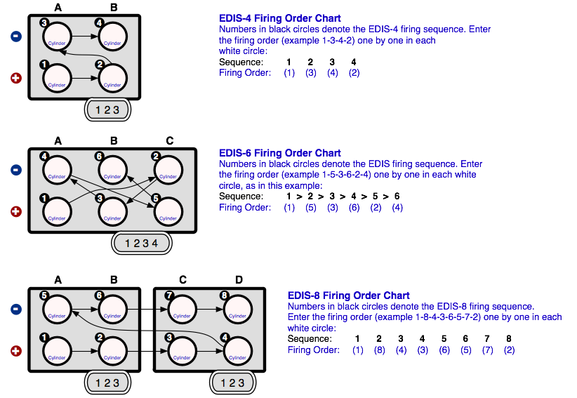

Here is a chart covering the EDIS-4, EDIS-6 and EDIS-8, enjoy!
EDIS-4, EDIS-6, EDIS-8 Spark wiring V1.2
edis4 edis6 edis8 wiring chart.png (128.57 KiB) Viewed 34345 times

This complete set of charts is excellent. May we have permission to add to our installation guide?

One small pick up i can see which you seemed to have correct on a previous post is that on EDIS 6, you have named the columns of coils A, C, B (in order). Yet they fire ACB but the way you have drawn the arrows it now goes A, B, C.

NITROPIXIE wrote:One small pick up i can see which you seemed to have correct on a previous post is that on EDIS 6, you have named the columns of coils A, C, B (in order). Yet they fire ACB but the way you have drawn the arrows it now goes A, B, C.
Good point, i thought it would be more intuitive that way, but as the standard seems to be to enumerate the coils instead of the firing sequence, i've corrected the chart and edited the post above. Thanks for pointing out!
