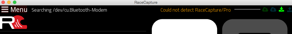

When I run RaceCapture I am still getting a continuous stream of searching for cu.usbmodem1411, cu.Bluetooth-Incoming-Port, cu.Bluetooth-Modem next to the Menu item but no connection. I get cu.usbmodem1411 in /dev. What else do I need to do to troubleshoot this?

Hi, are you on MK1 or MK2? We have a known issue for MK1 at the moment- on the Mac the serial port does not respond, even though we show it connected.

I am on a Mk1. That would explain it I guess.
Yes - sorry about that. There's something incompatible between OS X and MK1 in the low level USB layer that we haven't figured out yet. Windows, Linux and android will work fine, however.
