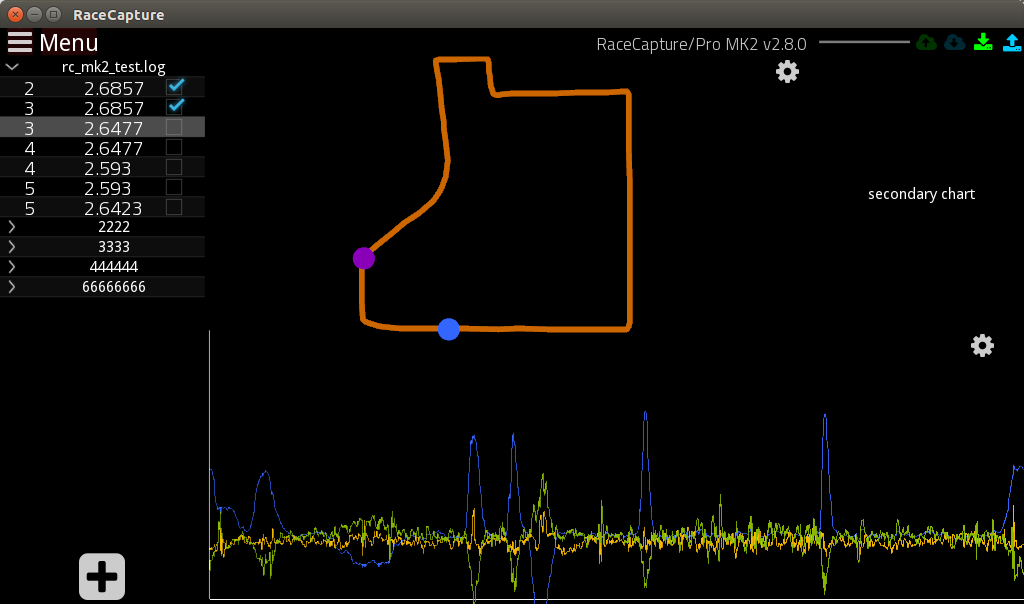

Here's a screenshot of the in-app analysis we're working on. The initial release you'll have an option to upload a log file, then later we'll add the ability to connect data streams from various sources. Initially, the analysis will be lap oriented - it'll look for incrementing LapCounts as a way to sub-divide the data into laps.
The theme for the analysis view will be similar to the dashboard view: arrows on the bottom of the screen will let you page between different analysis views while being able to select and compare laps from different sources. We're pretty excited about it!
Another big push we're doing simultaneously is to get the Android app *out* of beta and into the play store as official, finally replacing the old app for a fully unified experience across all platforms - windows, OS X, Android and even IOS coming up.
I apologize for the delay and thank you very much for your patience. We'll work to get an evaluation analysis mode in very soon. This has all been a ton of work, but we're very excited to get it out to you.
Also: We're working on the ability to upload logs after the fact to http://www.race-capture.com - so you can see your data using the same analysis view as we have for real-time telemetry. Should be available in a couple of weeks as we finalize our testing.

The lap oriented analysis sounds great for road racing applications. But what about autocross? We also have laps, except they typically are in different log files and called "runs."brentp wrote: Initially, the analysis will be lap oriented - it'll look for incrementing LapCounts as a way to sub-divide the data into laps.

What about Ubuntu support? The close, maximize GUI in your screenshot looks very Ubuntu like. Not that I want to bring my desktop out to my car, for in-car I use either an old Windows 7 laptop or new HP Stream 7 running Windows 8.1. But for analysis on the big screen Ubuntu support would be much appreciated.
Of course, if the online analysis of manually uploaded logfiles is good enough then there is no need for an offline version for at home.
One comment, with the online option you could potentially create the Strava of autoracing.

If I had to venture a guess, the Analysis portion is going to be multi-platform just like the rest of the Race Capture application so it should work on a tablet in the car, and for sure on a windows laptop.
