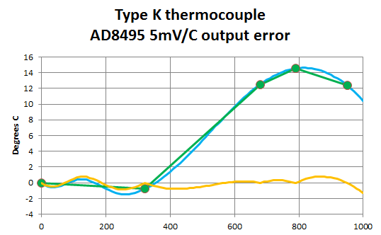

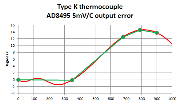

I had to take a look at how non-linear the type K thermocouple really is.. Here's a chart I made showing error between actual temperature and indicated temperature for a non-linearized thermocouple, at 5mV/C right from that chip/board. Worst case is indicating about 815C at 800C actual.
Seeing this curve, I'd pick the five RaceCapture datapoints at 0C (min), 350C, 680C, 790C, and 900C (max). This 5-point (4-segment linear) fit will keep you within a degree or two from 0-900C, with tighter accuracy from 350-900C.

Just a little more refining and tuning.. these five linearizing points keep you within +/-1 degree error from 0-988C, and 1000C is only 1.3C low.
New chart - blue is unlinearized error; green is the five points with four line segments; orange is the corrected error (staying within +/- 1C). If you're in the 900's your engine has bigger problems than one degree of error..

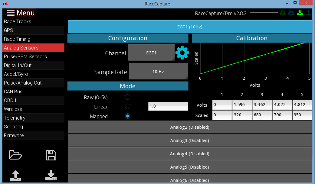

How would I go about calibrating temps v volts for this? Simply use the figures toga94m has given?
With this in mind do you think it should be easy enough to use the quad board with these 4 sensors?
Sensor config info is here - http://www.autosportlabs.net/RaceCaptur ... ate_Sensor you're going to use the mapped option. I don't have the EGT board, so this isn't tested, but here are my numbers stuck into RCP config. On the chart it looks like a straight line, but it's correcting for about 15 degrees of nonlinearity up around 800C.
