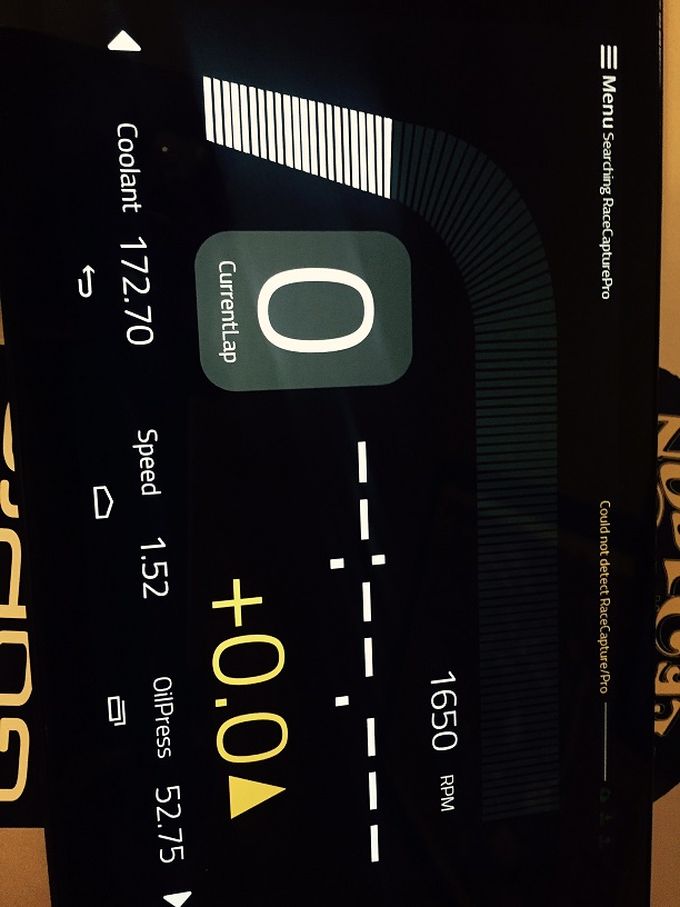

One question I had was if the segmented tachometer on the page with current laptime info (see attachment) should also have the same improvements? It still seems a bit sluggish and that will likely be my default view for the track (along with the 3 stage led lights).

Hi dotframe, glad to hear the latest release is faster for you! Yes, you are correct, the combined tach+timing view is still slow, we have it on our todo list to update that view too.
