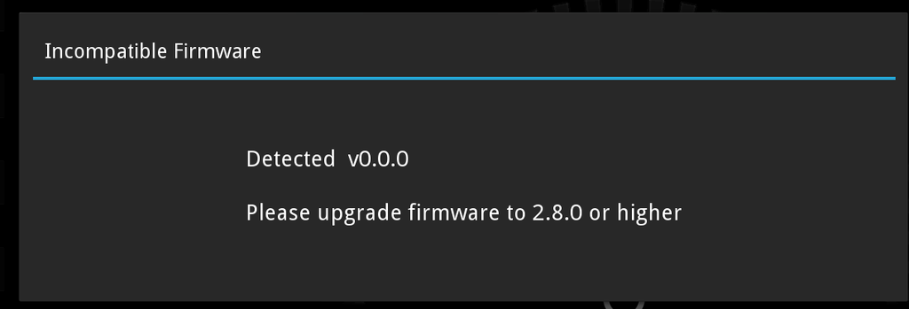

I now sometimes get this when I try to connect. Even though when I do successfully connect the top bar says 2.8.7

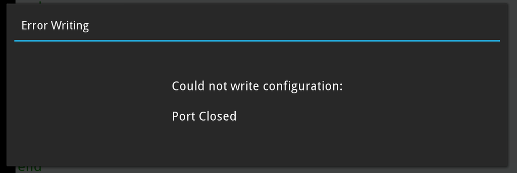

Post by zechdz »
This too

Now Im in situation that nothing allows me to update script:
- Flash firmware through bootloader (flashes, script stays)
- resetConfig through terminal stucks after Flashing Default Logger Config PASS
- press button shortly within 5 seconds after load - doesn't stop script from loading
- writing script through the App - timeout waiting for setScriptCfg
- Reload of config says "Port Closed"
Spent few hours already.
It shows me that old script sometime and then it goes to disconnect-connect cycle so I can't read log or update script.
It shows me detected v0.0.0 and so on once I'm trying to read a log.
